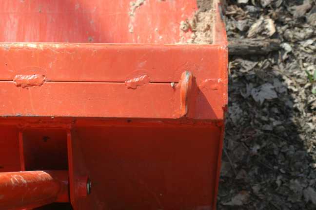

I'm going to weld on three hooks to the bucket. Does anyone know a close match to the Kubota paint color? The last time I bought color matched paint for my Cub it cost 16 bucks for spray can, so I'm looking for a color match from any source.

If the upper edge ( lip) on your FEL bucket is anything like it is on my FEL for my B3030 I cant believe it can handle "doodlie squat". Its THIN...and ( on mine) WAS NOT a "full box section". I backed mine up with a piece of angle that was 1/4" think and 2 x 3...and it makes it LOOK like a full box structure..but I welded my hooks to the HEAVY angle instead. ( Approx 1" long welds about every 5-6 inches on both edges of the angle iron)
As far as paint goes..I havent found ANYTHING that matches the Kubota as well as the Kubota paint itself ($10 a can here) and it does a good job. "I'm TOLD" that if I take a new part ( non faded) to a regular paint SHOP...they can scan it with a color gun and mix paint to match...its a LOT BETTER paint..but it aint no cheaper at all!
