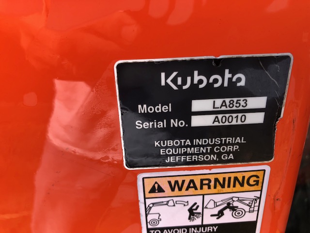

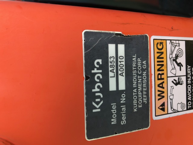

Here is a before and after photo of my loader when I purchased it. You can see what the paint looked like after compound, polish and wax. Made a huge difference and your tractor is a year newer. Of course, it isn't forever and you may need to do this a couple times a year but at least it may put off a paint job.

I will certainly give that a try on my L48 Kubota, but compounding the backhoe actually seems like it would be more difficult than repainting.

Repainting is a lot like compounding just with a much coarser sandpaper. I can't imagine it being nearly the work that degreasing, sanding, priming and painting will be. Worth a try.
