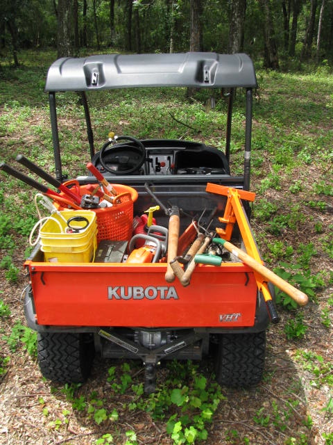

The rear suspension springs on the RTV500 have five adjustment positions, it ships from the factory set in center position, #3.
It is easy to adjust the rear springs with a pair of Channel Locks over the housing, using a rag as padding. Set in the softest position, the ride is much improved. When you look underneath, the adjustment positions are evident. Adjustment is covered in the Owner's Manual using a special tool, which is NOT available from Kubota/USA. Channel Locks clamped over a rag performs adjustment fine.
I have the driver's side spring in position #2, passenger side spring in position #1, softest ride. It is level.

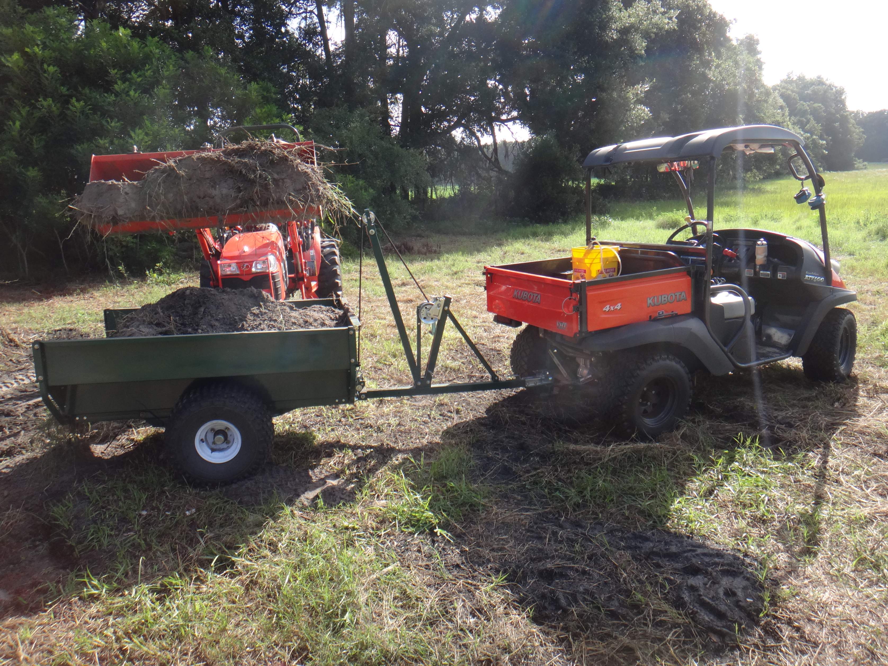

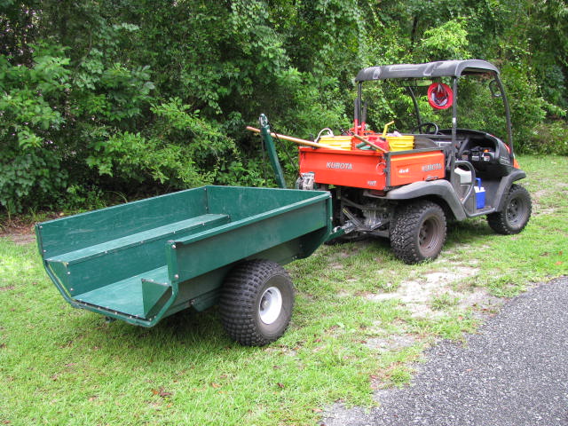

Hitch: Hitch 2 inch Ball 1 25 inch Receiver ATV Tek Four Wheeler UTV Garden Tractor | eBay
Curt 459 3 in 1 ATV Multi Use Ball Mount | eBay Curt hitch, which I have, must be shortened to fit RTV500.

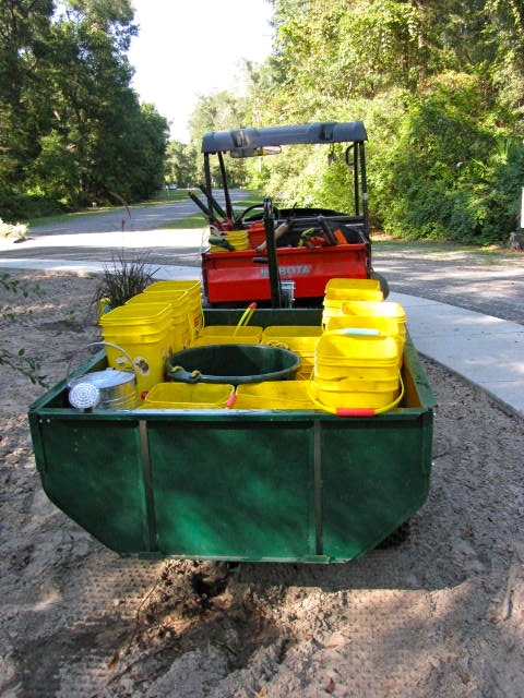

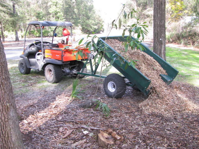

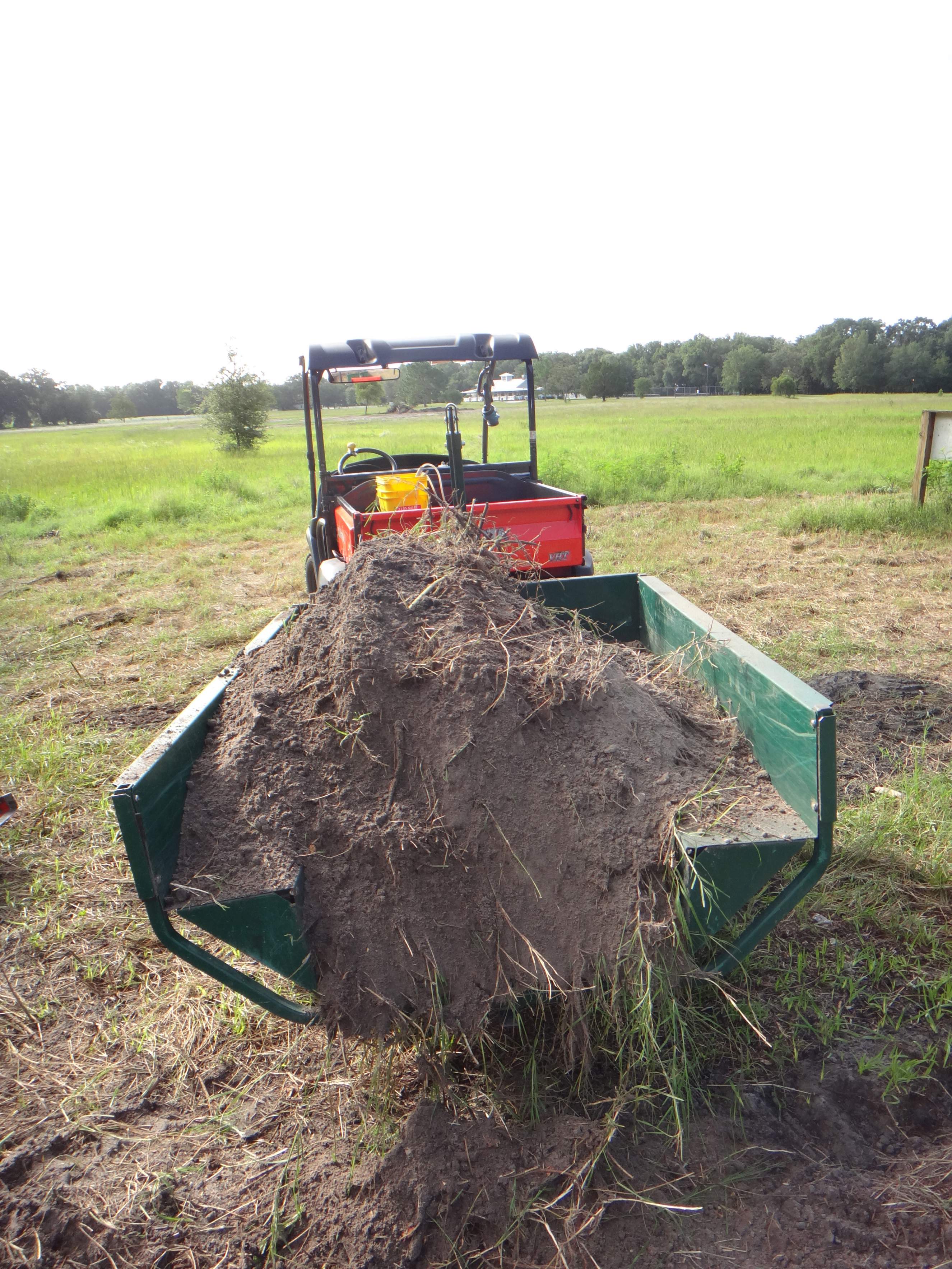

Trailer is an old MUTS: MUTS - Multi-Use Trailer System for your ATV, Quad and 4 Wheeler
