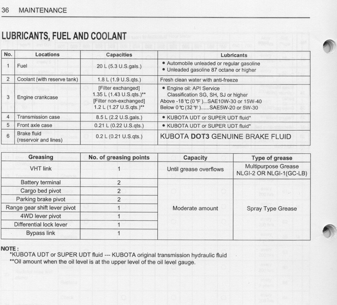

Mar 4, 2012 / Kubota RTV 500 Oil Maintenace and Storage #1 C celmerr New member Joined Mar 4, 2012 Messages 2 Location Stanfield, AZ Tractor Kubota RTV 500 Want to change oil. What weight and type oil is best. Regular or Synthetic. Misplaced owners manual. Also. I'll be storing vehicle for 9 months, any suggestions about draining gas etc would be appreciated.

Mar 4, 2012 / Kubota RTV 500 Oil Maintenace and Storage #2 amigauser Veteran Member Joined Oct 11, 2005 Messages 1,198 Location Unionville, Connecticut USA Tractor Kubota B2601 See attached. I personally would use Synthetic but totally up to you. You can add the marine stabil or StarTron to the gas. http://mystarbrite.com/startron/ http://www.goldeagle.com/brands/stabil/products.aspx Attachments Manual.jpg 218.6 KB · Views: 1,422

Mar 4, 2012 / Kubota RTV 500 Oil Maintenace and Storage Thread Starter #3 OP C celmerr New member Joined Mar 4, 2012 Messages 2 Location Stanfield, AZ Tractor Kubota RTV 500 Thanks, I'll go synthetic and try the StarTron product.
