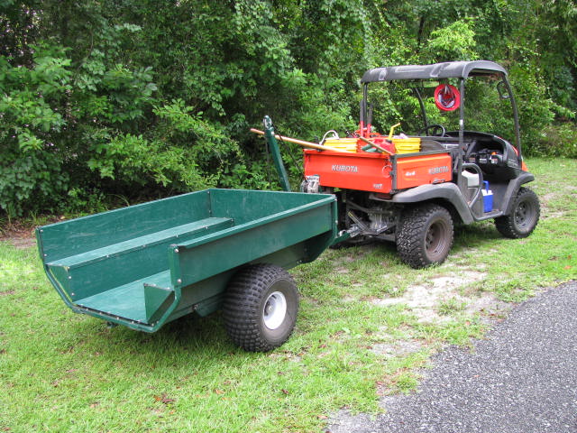

I have an RTV500 with optional wide Turf Tires. I have pulled a single-axle, 350 pound, Canadian MUTS trailer, with standard (15-psi max) wide tires, over-loaded with 1,000-1,100 pounds of dirt on LEVEL asphalt private road without too much strain, although it takes the combination a while to reach 15 mph speed. I am doubtful that an 800 pound load plus a 350 pound trailer is do-able up a 20-24% rough grade. There are no brakes on ATV trailers. A loaded trailer trys to push the towing vehicle when there is any "slack" in the tow and there is potential for jack-knifing the combination possibly turning over either trailer or towing vehicle. Also, you will likely be in LOW range/4-WD so momentum will not be available as an assist. You are hoping for too much from 15.8 horsepower.

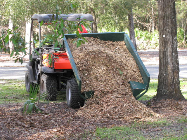

I have backed up the MUTS loaded with 500 pounds of spoiled wood and brush up a rough burn pile embankment for 25 feet before tipping the load and this has been fine.
The trailer + wheels/tires you use will make a big difference. I bought the MUTS because it carries the load LOW, between the wheels, so loaded trailer is stable; MUTS comes standard with very wide low-pressure tires. Half the ATV trailers sold, in contrast, carry the load on a flat bed above the wheels. While I have no experience with the latter, the load being above the axle must make the loaded trailer more "tippy".
Reviewing my RTV500 specs I see Kubota gives a towing max of 1,102 pounds, which would INCLUDE weight of the trailer, for the 1,300 pound RTV. I wonder if this allows for the tools you will soon accumulate in the vehicle bed? See photos.
With the appropriate trailer I would think 400 pounds + 350 pound trailer (( NO PASSENGER)) up the slope would be safe. Only my opinion, not a recommendation. Any reason you cannot make multiple trips?

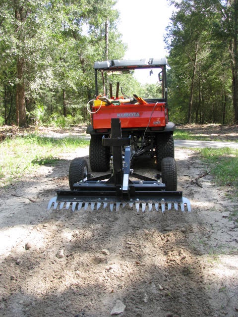

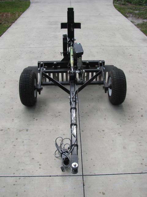

What "makes" the RTV500, in my opinion, is the HST transmission. Not sure you will find it exceptional during a test drive but when you begin to tow, pull or harrow the HST tranny is most impressive.
Get the optional $250 wide turf tires. They give better traction than standard, smaller ribbed tires and the ride is less jolting. Money well spent.
I have had my RTV500 in commercial use for 18 months and nothing has fallen off, nothing has broken. ( I rarely let anyone else drive it.) Turf tires hardly show wear.
Kubota quality.
