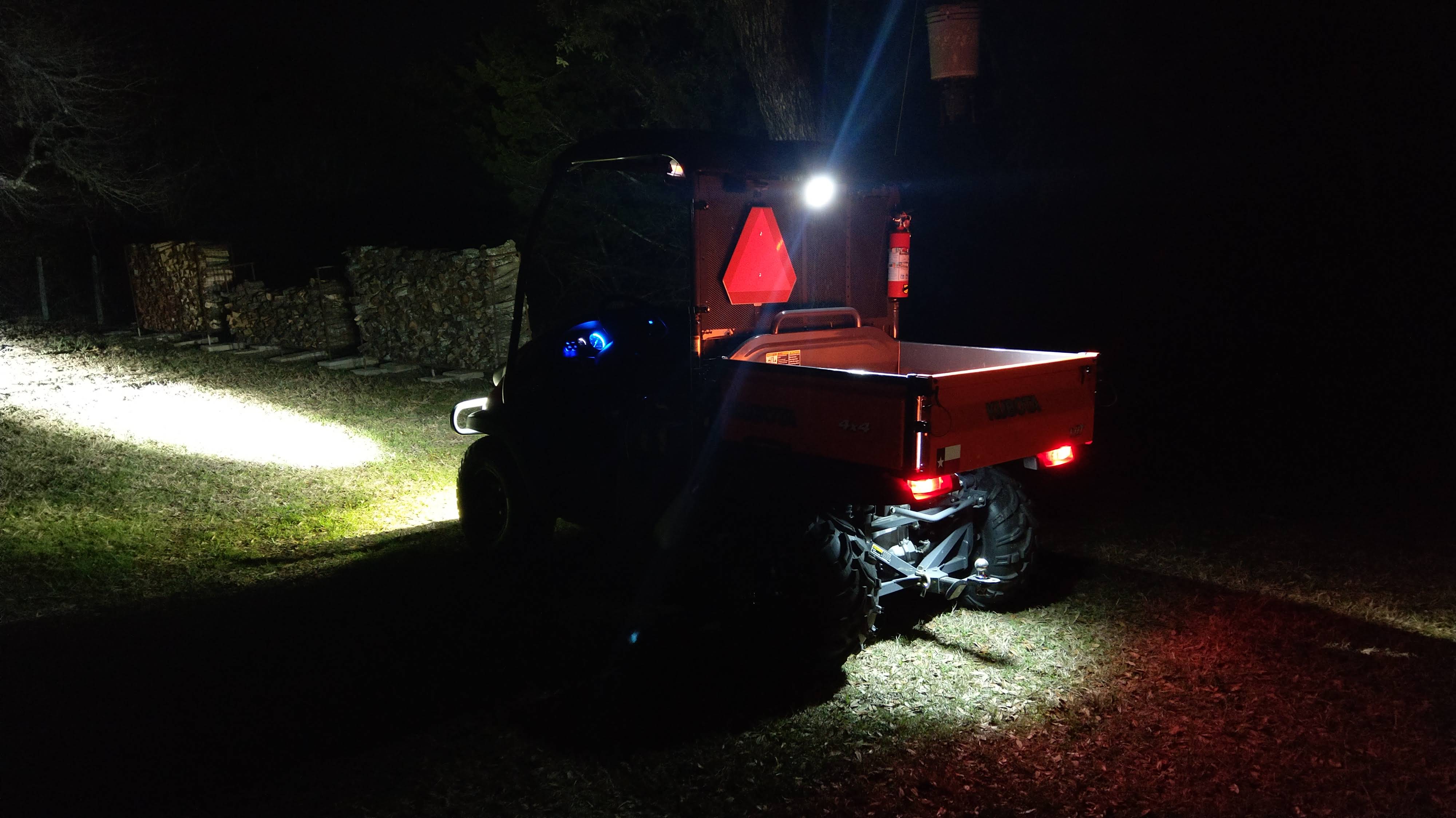

Is there anyone out there that has added after market work lights to their RTV 500? I am wondering if you were able to run the wires up through the roll bar or externally. Thanks.

On my RTV X1120D, I ran the wires external with split loom tubing and zip ties. Didn't see a good way to run them internally.

Thanks for the reply. Internally through the tubes looks like a PITA. I wonder how the dealer installs the OEM lights.

Ran mine externally as did “Ronster” drilling into the roll protection would be a pain and possibly compromise them in the long run black split loom blends in well

I did only 1 LED on the back and a small under the bed to light up the hitch for night ops. I also did a small light bar in the front.
