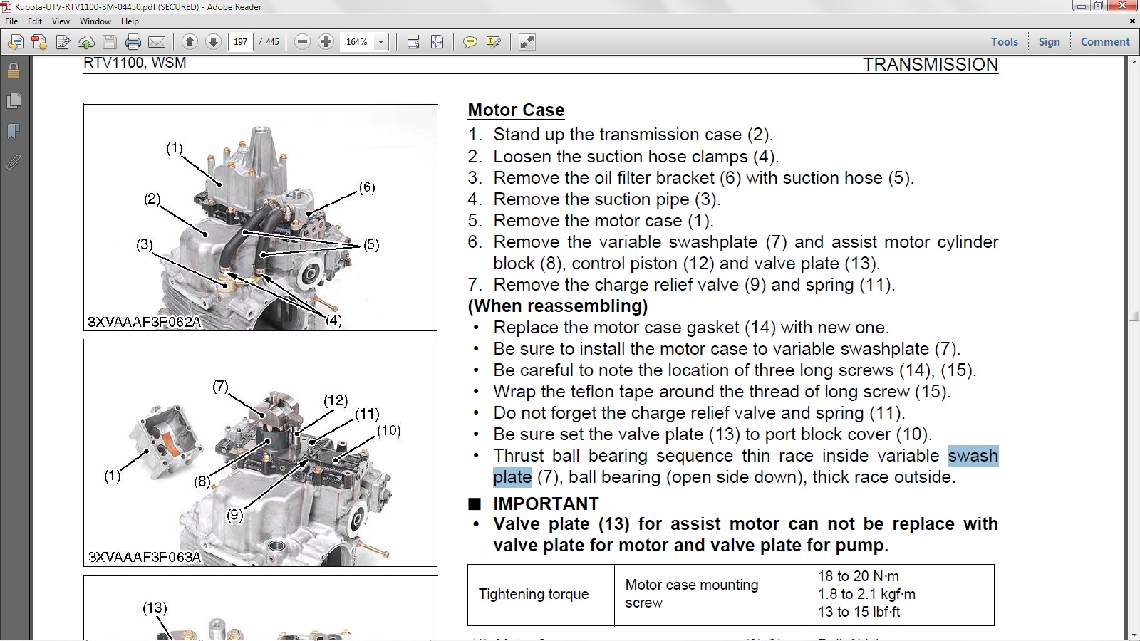

Hi I have recently bought a 2009 kubota rtv 900 the engine runs fine and it's seems lively, but when you put it in any gear and rev it seems to have very little power and is very slow tops 15mph, it still stops dead virtually when you take your foot of the throttle, the hydrolic oil looks like new and is up to the levels, do you know what the problem is? Iv read about swash plates, how bigger job are they to replace? Thanks james

Hi thanks for the replies, I know they aren't speedy machines, we have a older 06 one and that's fine but our new 09 one that we have just bought has hardly any power seems it can hardly move l have checked the brakes it rolls ok, from researching I think it must have worn swash plates, how bigger job are they to replace? And is there any threads showing how its done? Thanks james
   / Kubota rtv 900 no power #6
Perhaps these will help. Doesn't look like too big a job. Easy for me to say eh!:laughing:
RTV1100 but the 900 version would much the same. Everything is under that one cover.

Hi thanks for your replies iv took it apart and the 3 swash plates do have very slight scooring but only very slight you can hardly feel the scoors with you finger, would that be enough fto cause the massive power loss?, also the was some very fine metal filings in the oil, thanks james
   / Kubota rtv 900 no power #9
According to this page, you need to replace the parts.
I'm assuming any scratches would hamper the smooth engagement of this unit and ruin how the transmission reacts.
Possibly sticking and not allowing it to shift to high, the possible cause of your troubles.
