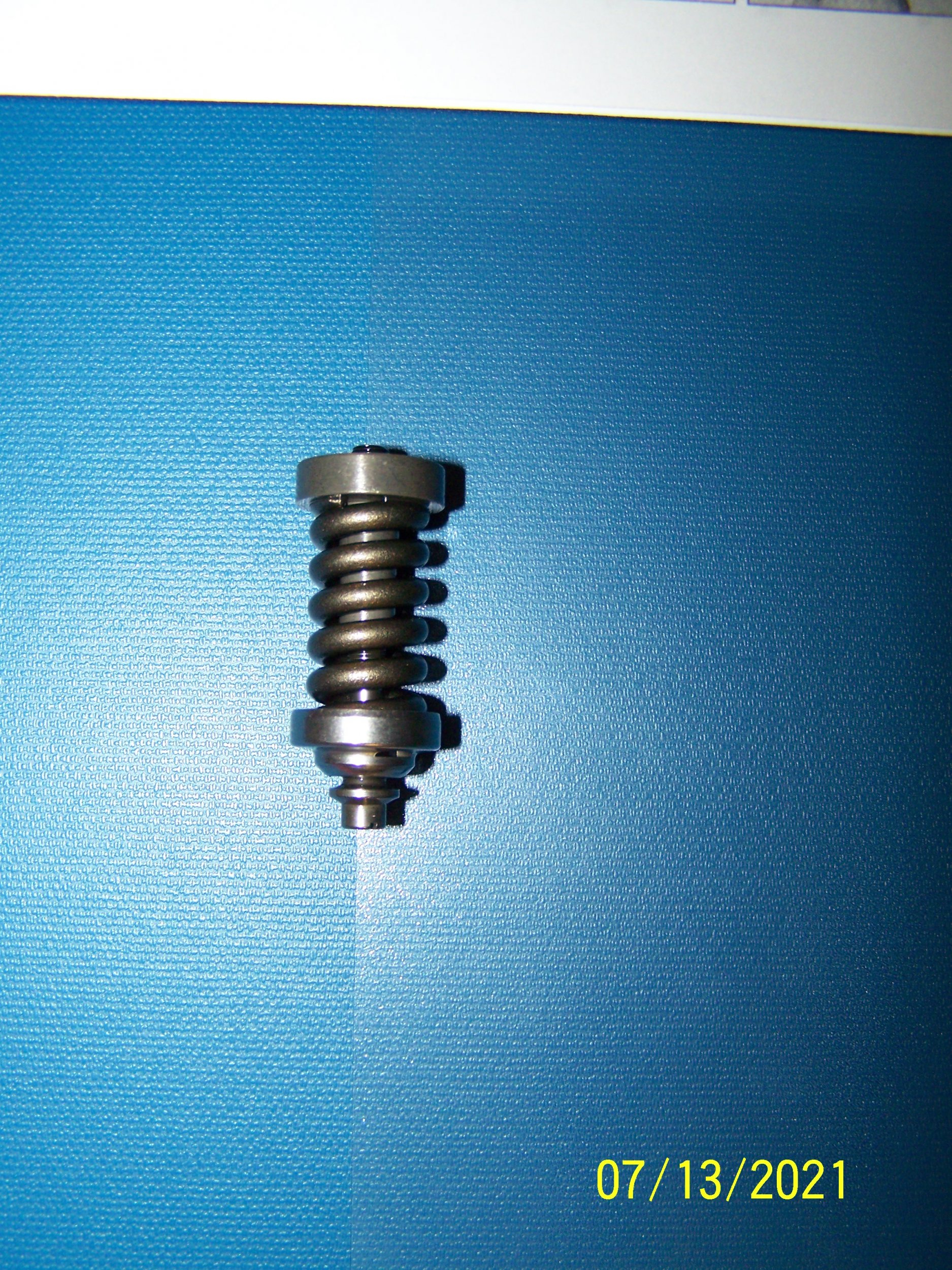

Several years ago I replaced the HST relief valve in my RTV900 with a coast valve. Coast Valve Kit for Kubota RTV900, RTV1100, RTV1140
I wanted to eliminate the quick deceleration when you let off the throttle.
While messing around with this valve I noticed that if I decelerated then "hit the gas" I would get a (short) lag in the transmission as the pressure built up, then it would take off.
Just a guess, but I suspect your relief valve may be sticking. It looks like this
You may want to run this idea by Kubota. I'm not a mechanic.
BTW it only takes around 15 minutes to change this valve.
