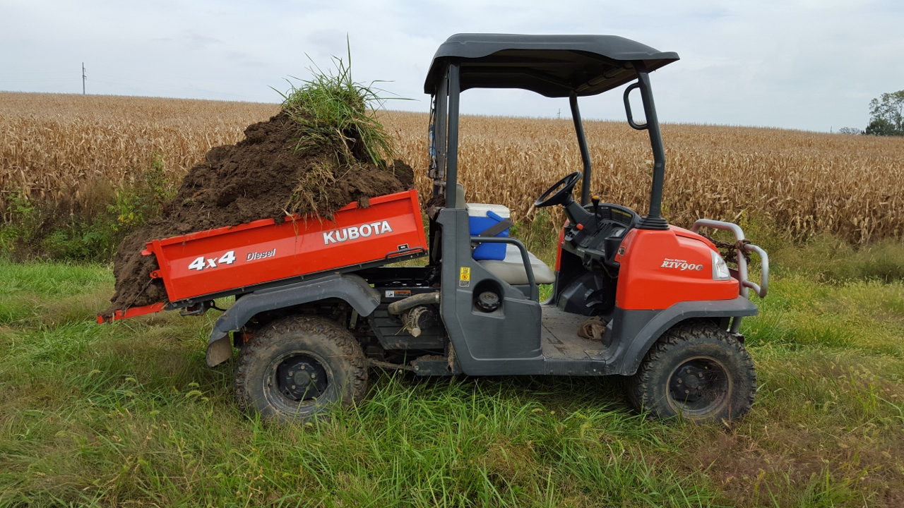

According to a Google calculator the Kubota cylinder has 7,850 lbs of push. Push lifts the bed.
It will dump this.

Ouch!!! That left a mark!!!! And there's a lot missing according to the picture!!!!

Double ouch. The bed on my wife's (notice I don't say mine, she bought it) Sidekick has an over center hinge so it dumps pretty easy and the linear actuator has no issue with it but I've never heaped it up like you Richard. My wife would kill me if I did that. In reality it's out 'go uptown' ride and ride around the neighborhood spying vehicle.

Yes, I too never had a problem dumping a purposely over-loaded bed with the factory system. It made me smile every time!
