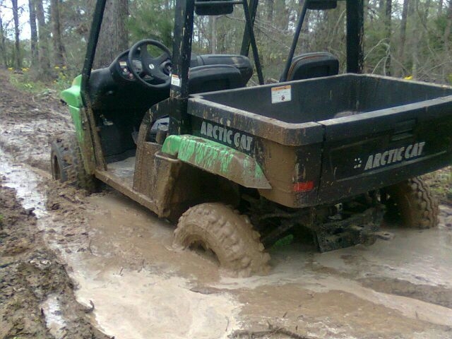

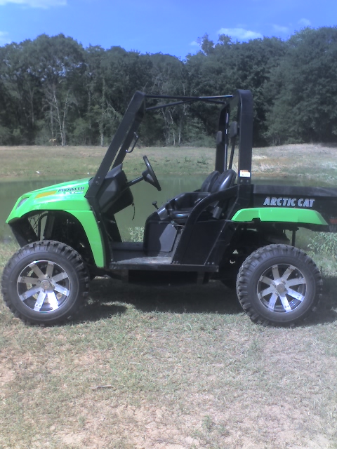

My opinion would be get aggressive same size or one size larger if will fit and a good winch,that will mount on front or back. I have one thats welded to a reciever hitch but its a pain if your already stuck and need to dig down and get to the reciever hitch. Maybe Titan 589's and Warn,Ramsey,Milemarker winch(4500lbs and up),tree saver and snatch block.... 08-16-09_1553.jpgstuck prowler.JPG
