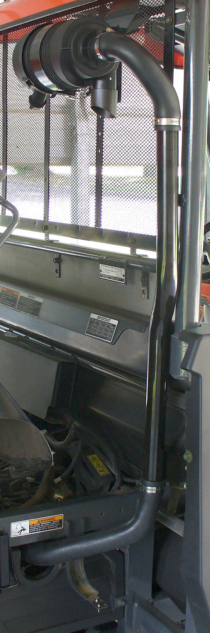

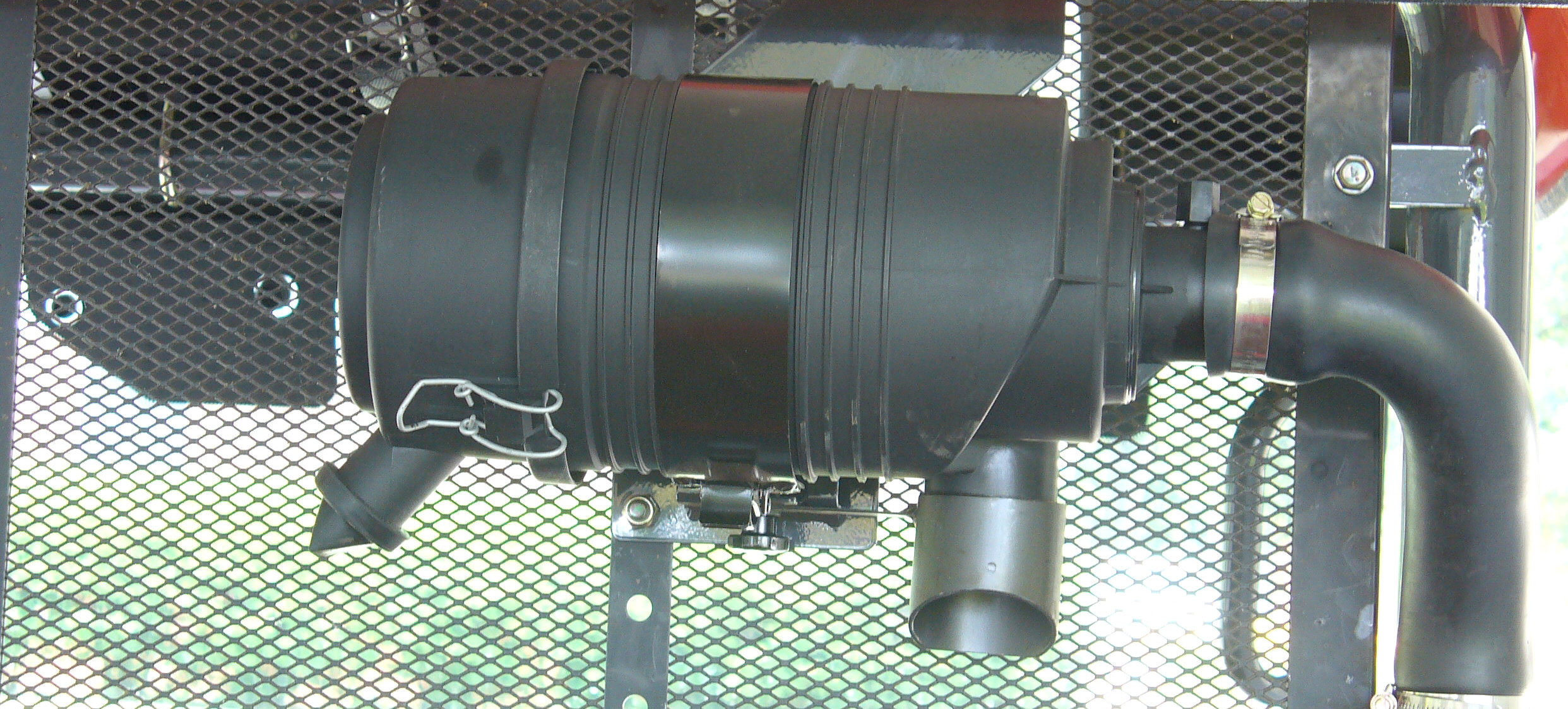

Just received & installed a High Air Intake for my RTV. This is going to be one of the best attachments I believe anyone can put on one of these units.
It is a OEM from Kubota theconversion kit, that brings the air intake from behind and below the cab to high behind the cab. The kit includes all tubes, hoses, clamps and extra nuts & bolts, new air box & filters for the job. Takes about 40 minutes to intall. This will keep the expensive filters clean & when going threw deeper water, will keep the air intake dry....... Shipped from my dealer to my home wasn't but $166.00 ~~~ didn't think that was bad considering it is taking care of a expensive little hunting machine ........

THESE ARE ORIGINAL KUBOTA PARTS *** AND THEY FIT PERFECT!!!
Part # V4271 High Mount Cleaner ROPS Kit ~~~~
This is for the units without the cab.( this is the one I had my dealer to order for us, matter of fact, he ordered two extra for his personal units he uses on his farms.) This is going to be a big plus for me out in the swamps, and on the plantation working my summer & winter deer plots.
Other Cleaner Kits are:
V4272 High Mount Cleaner Cab Kit
V4273 High Mount Air Cleaner Cab Conversion Kit
Around here, we've been calling it a "water forwarding kit" ~~~~
