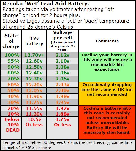

Start it up and use volt meter to check voltage across battery.... It should read about 14 volts DC with engine running... If it is about 14.5 volts or above yes you are over charging battery, and yes alternator or voltage regulator may be culprit.....
At rest (engine off) battery should read about 12.8 to 13.2 volts...
IF you reversed the leads jump starting you could have damaged something, BUT if you were positive to positive and negative to negative, it should not effect anything in either car or tractors electrical system..... Jump starting tractor is just same as car to car or truck to truck or car to truck or, well I will stop there....

Mine shows 12.8 not running and 14.5 running. It's a 2014.
   / Kubota rtv900 Electrical short #4
Agree, voltages are within margins of the average meter
The battery can also start swelling from a shorted cell
