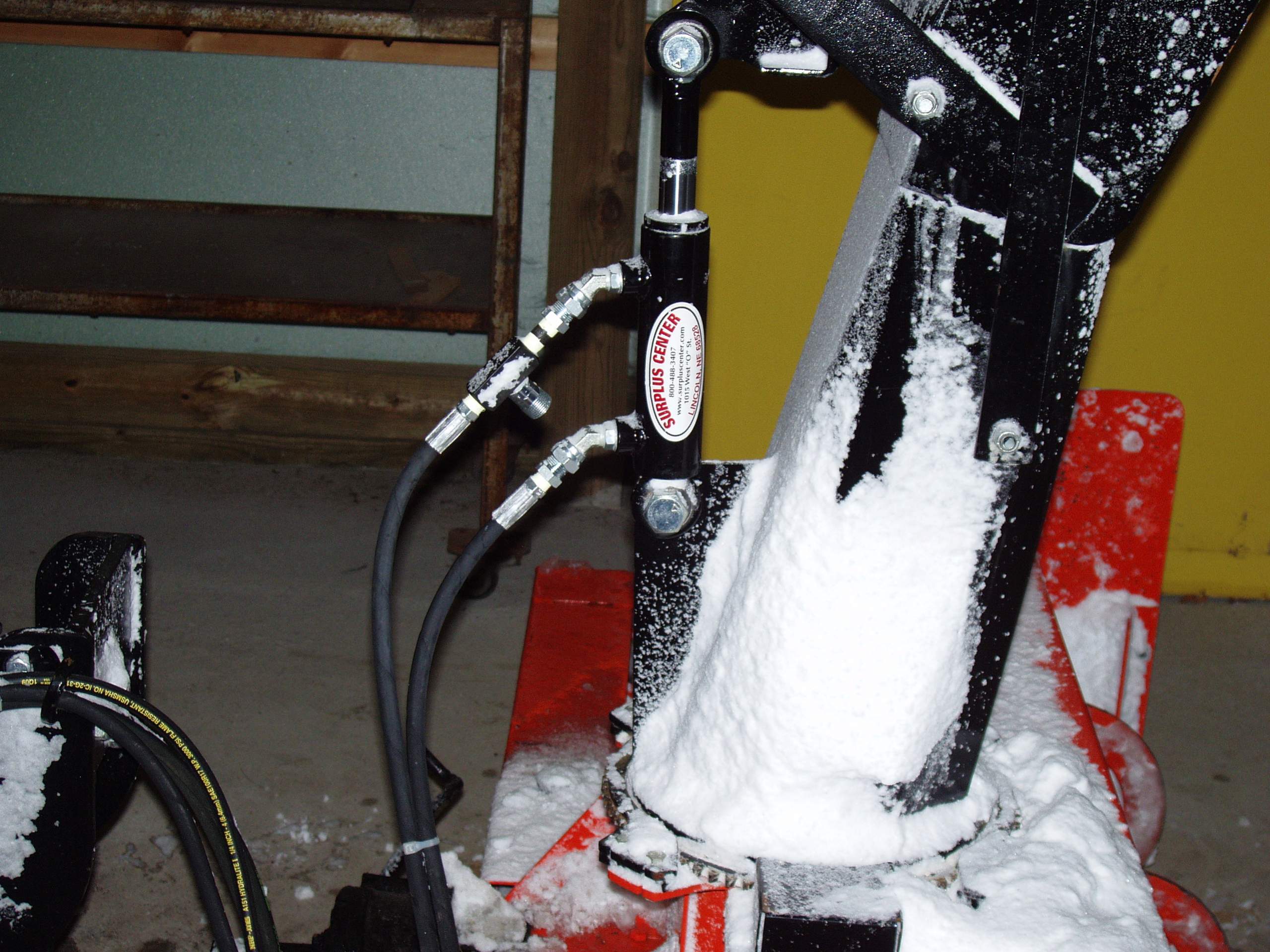

I done my shoot flipper with hydraulics so I would not have to deal with this issue.

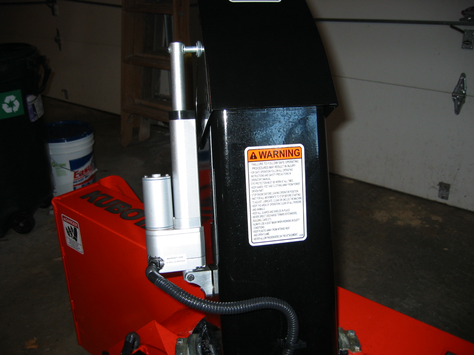

I used this actuator I bought from Surpluscenter.com. I paid just around $100 for the actuator,bracket and dash switch.
