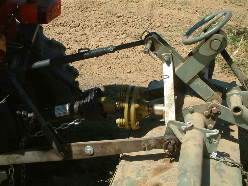

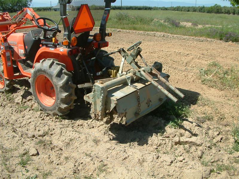

Your shaft probably is 1 1/8". You can find adapters that will get you from 1 1/8" to the more common 1 3/8" that you find on most pto drive shafts.
I had a similar problem adapting a used Yanmar RS-1200 tiller to my Kubota B7510HST. The pto shaft that came with the tiller was shot so I bought a new shaft at Tractor Supply. Fortunately the tiller came with a 1 3/8" 6-spline male shaft on its gearbox. However, that tiller does not have shear pins so I had to buy a slip clutch. And to get the slip clutch to fit the tiller without rubbing on the tiller's sheet metal, I had to get an extender that spaced the slip clutch 6" farther away from the tiller.
To get all that drive train stuff to fit on the B7510 I had to remove the 26" long lower lift arms that come with the 7510 and use the 35" arms from my MF-135 tractor.
The photos show the resulting configuration.
