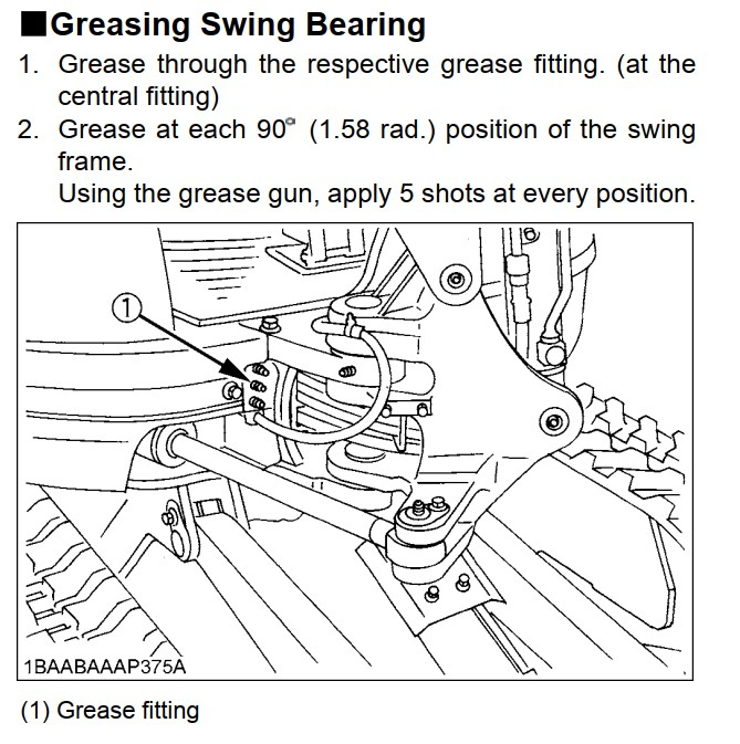

Reading maintenance section
of manual illustration displays

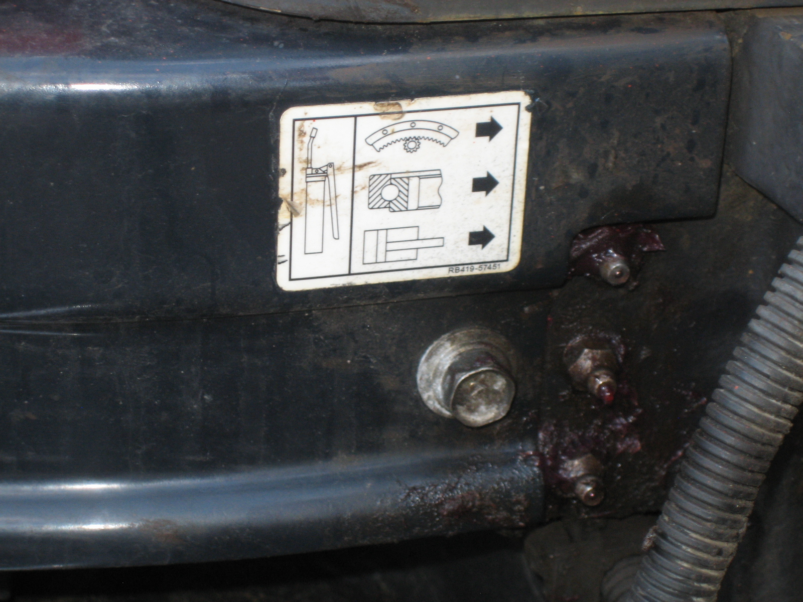

Rotating Gear for "House" as center grease fitting.
Label on machine indicates top fitting?
Others with a U25 have the same
discrepancy?

Top fitting is for the ring gear, middle is for the house bearing and the bottom is for the swing cylinder. Both sticker and manual are correct. The picture of the manual says: "Greasing Swing Bearing."
