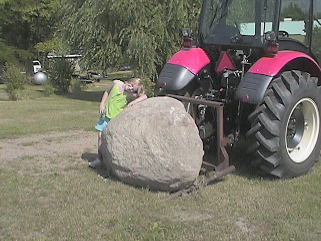

I just came back from a local ag show & saw my dealer with a MFWD cabbed Zetor 6441 with a price of $28,900 in the window. Zetor was the mfg source for JD 2240-2840 series utilities sold in South American markets.
I stepped up from a JD A to a cab Zetor 55PTO MFWD and someone :mad: has managed to mangle my 8' attachments. The MFWD will pull about 25-30% more than 2wd.
http://zetorna.com/html/Brochures/ProximaPlus_2007.pdf
One thing to add on the config sheet is a jump seat in the cab for those visiting passengers or future farmers?
Pix of helper, rock found with the plow.
