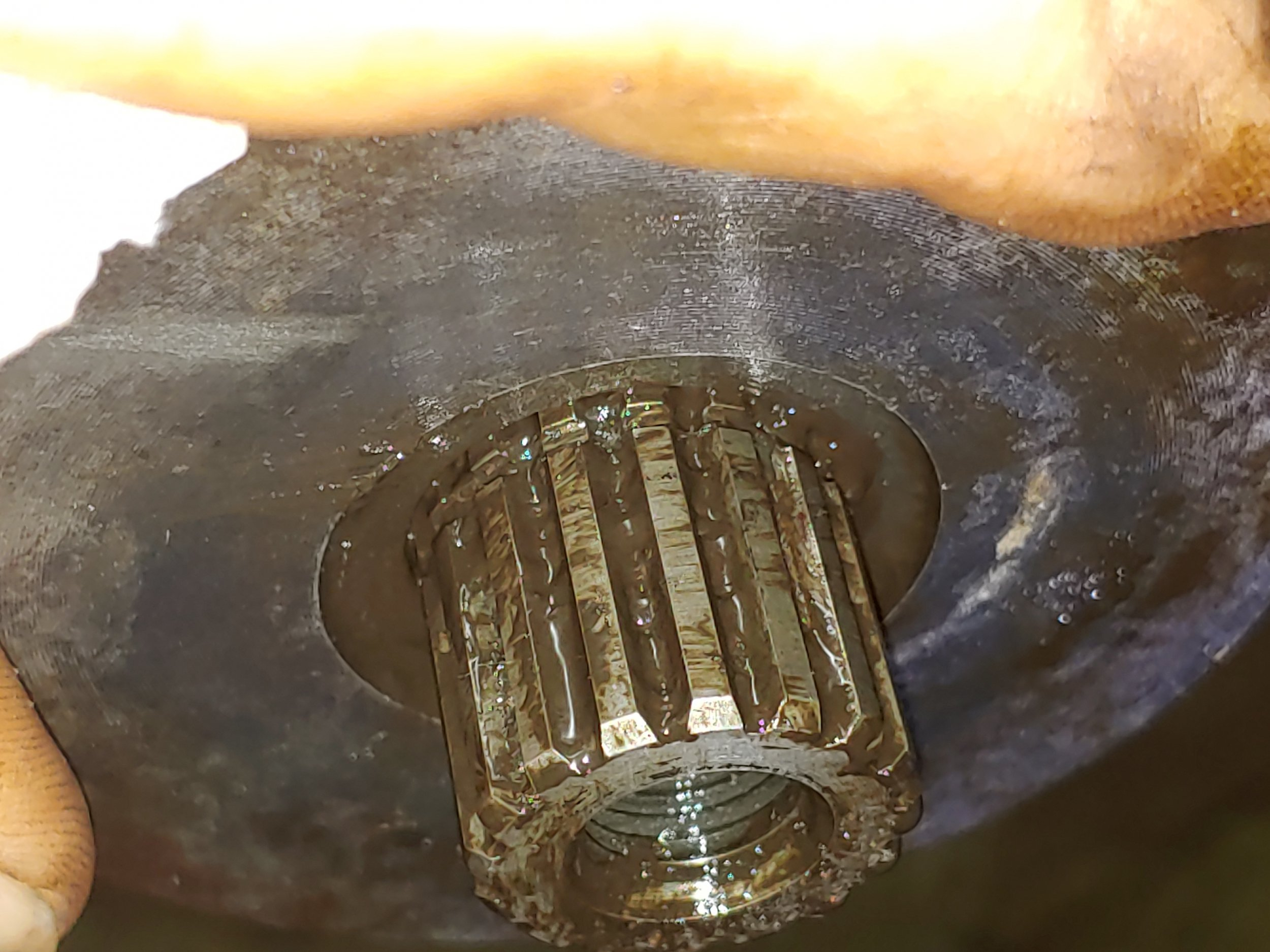

I finally had to give in and do that. Here is a video and pic I shot of what is going on.

I'd be trying to press that out. It doesn't look like any snap ring is left anywhere and the parts is being a bugger to disassemble.

Yes it looks like the snap ring somehow slid off and is far inside the "bushing".
I would be careful and try not to damage the spindle since it may be pricey.

Quick update.
I was able to get the bushing off the spindle with the pulley puller. Once I got it off, I saw the the top inside of the bushing had a little squash damage causing it to catch on the splines. It came off without applying a whole lot of pressure, thankfully.
Once I got it it off I removed the gear box. I noticed there was some play in the output shaft. Assuming it was a bad bearing, I disassembled the box and inspected everything. To my surprise the bearing seems to be good. There is no lateral play in either of the races and it is smooth. I pressed the shaft out of the bevel gear, which is pressed into the bearing. After inspecting it I didn't see any obvious damage, so i'm a little confused about what is going on here. Any ideas? Or does the spindle bearing stabilize the shaft making this normal?
