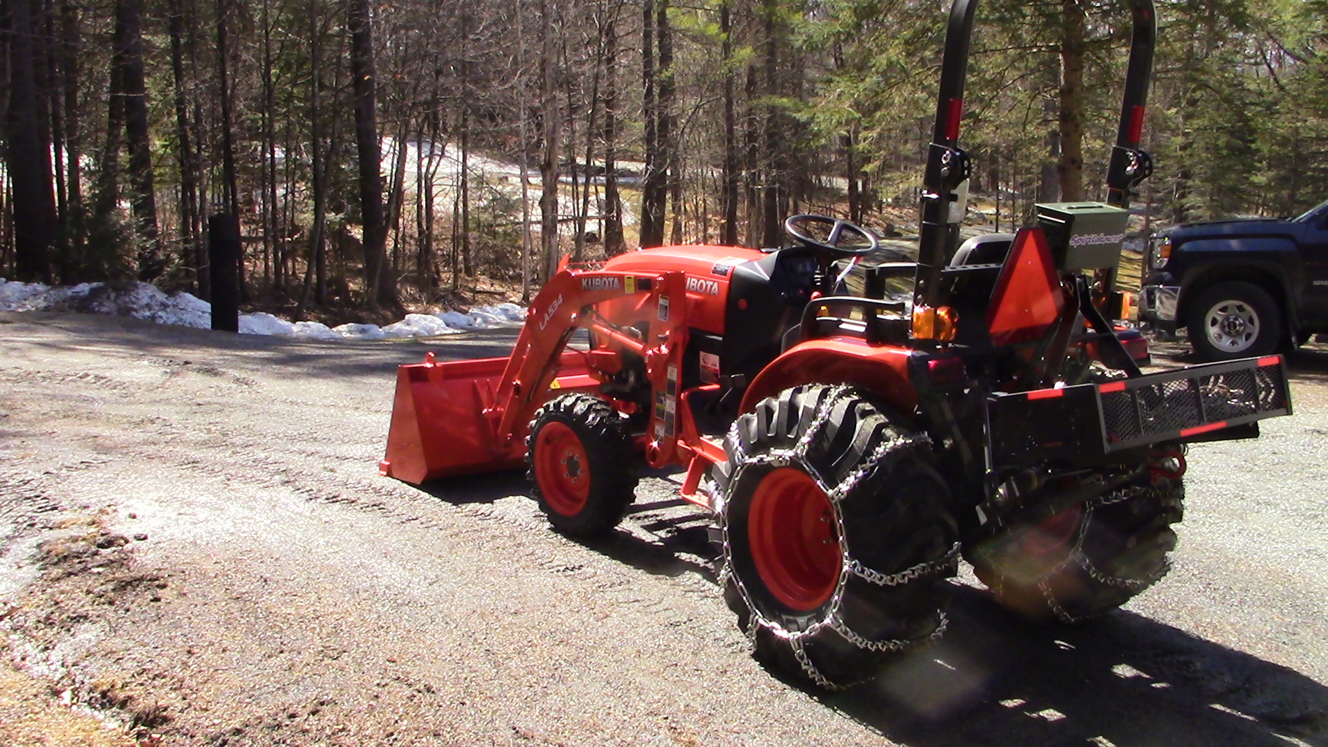

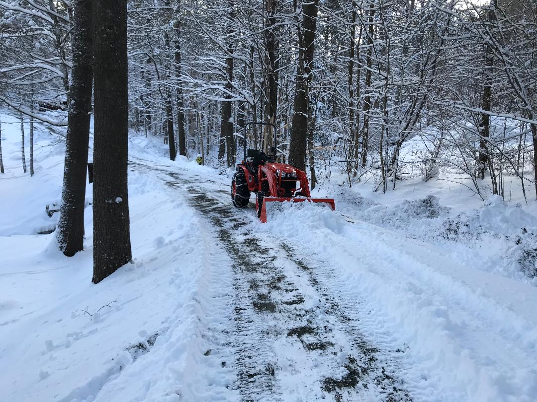

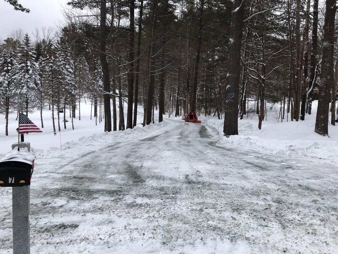

I have a Kubota B2650 which struggles in 8 inches of snow. It has an agricultural type tire. Anyone have suggestions for chains vs tire weights? I appreciate any thoughts.
   / Kubota #2
I use ice chains and rear tires are loaded plus rear blade only need 4wd 5 times.
