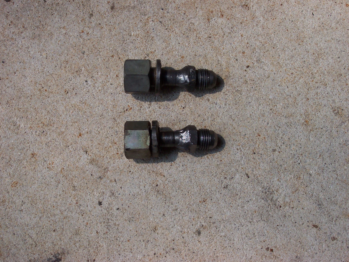

Brazing or O/A welding will fix it easily.
I had to make a couple adapter fittings for my Jinma Hoe because local hydraulic shop could not match them.
I just O/A welded the old fitting to a new JIC fitting and installed JIC hose.
