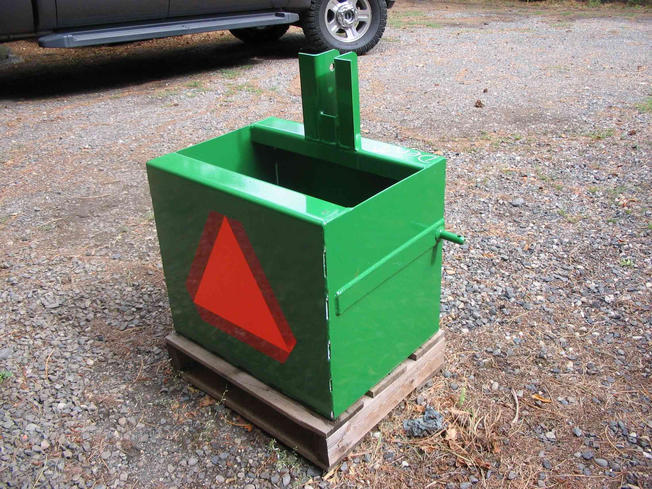

Just finished customizing my new John Deere ballast box.
Wanted to make it a little more usefull for hauling my typical grounds maintenance tools so before filling it with concrete I added some hooks and eyes and three 4" tubes to hold chains and tools.
Here is the original box. At this point all I have done is seal it up.

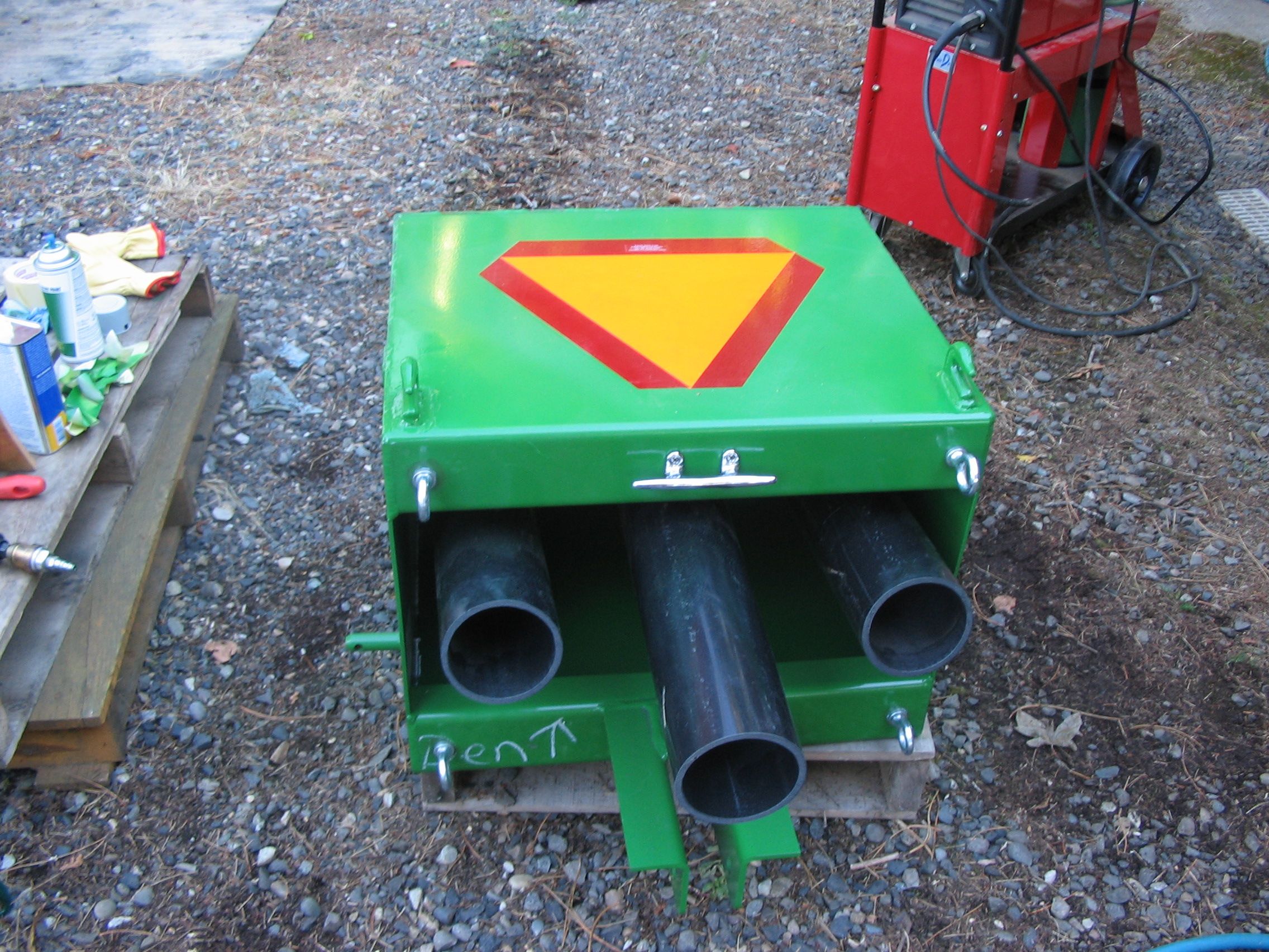

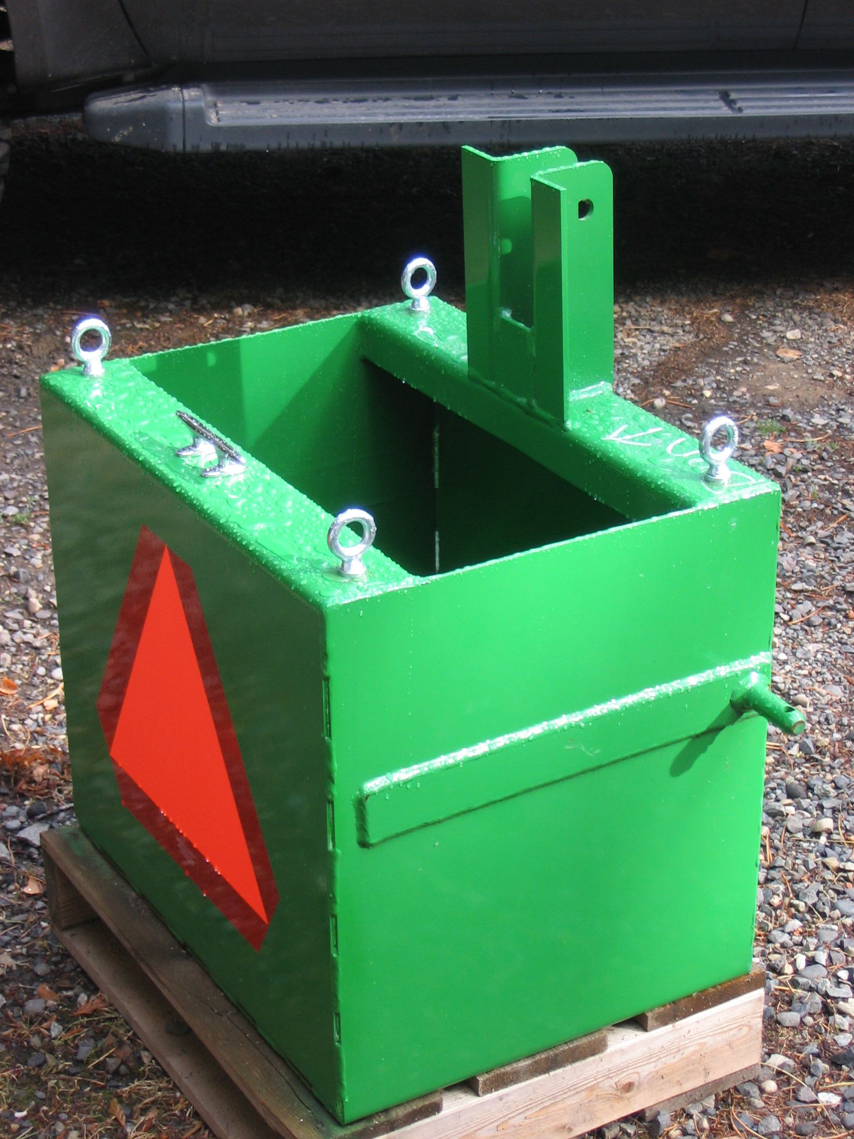

Here I have added removable eyes at the corners and a cleat at the back.
Sometimes I just need somewhere convenient to tie off a line.

This one is after glueing in the tubes. I used a polyurethane glue. There are drain holes at the bottom of the tubes. The two outside tubes are canted back about 15 degrees. Those are for rakes and shovels. The middle one is longer and straight up. I will use that for the pole saw.
I also welded some 5/8" grab hooks on the back. I can hang chains off the hooks or in any of the tubes.

Concrete poured. 7 80lb bags. I had guessed 8. It probably would have taken the full 8 without the tubes.
   / Kustomized Ballast Box
Concrete sealed and painted
