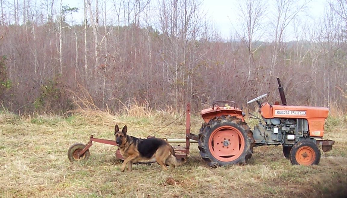

Here's a photo of my tractor ... and dog.

Like your dog... tractor is ok too .
Top link should be a cat1 may be a short cat1, measure what you need and try to find one that will adjust a little longer and a little shorter than what you need. KennyV
