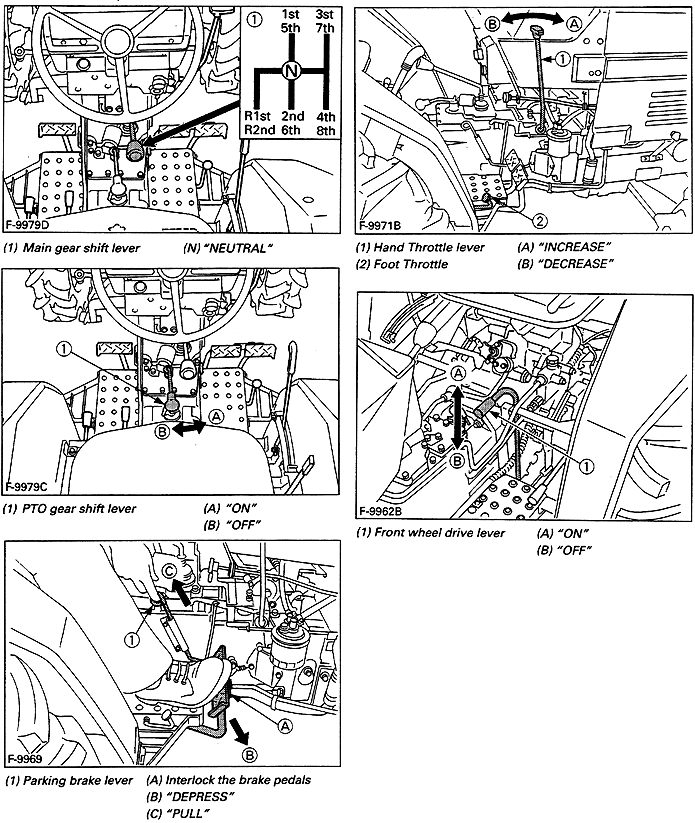

The tractor appears to be in good condition with only the slightest indication of dampness at one seal on the left side of the centerdrive line tunnel about 3 inches down from the top and about 8 - 10 inches forward of the shift lever where there is a moveable rod about 5/8" diameter that comes out the side of the case and bends towards the rear.

It dsure look like the front wheels could be rotated left to right and would add about 6 inches. I have not seen the owner's manual on this. The fronts were reversed on my Deere; which was also a vineyard lease return. What is the bent rod coming off the left side of the driveline tunnel?

</font><font color="blue" class="small">( What is the bent rod coming off the left side of the driveline tunnel? )</font>
My tractor lives about 120 miles from where I do, so I can't easily run out and look/take pictures right now. /forums/images/graemlins/crazy.gif
See if the attached snippets from the manual show what you're talking about.
Heck, I'll feed you the whole manual, little bit at a time. /forums/images/graemlins/grin.gif
