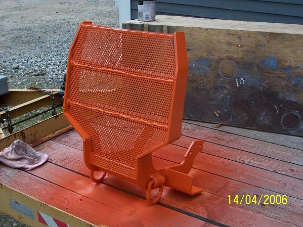

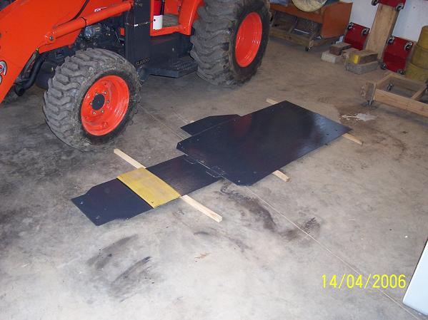

After close to a year of owning my L-39, I finally got the time to make a skid plate for it. It is similar to the skidplate I made for my BX 2200, with the exception that the L-39 skidplate attaches by homemade "U" bolts to the loader frame. The BX 2200 skidplate attaches to the midmount mower frame. If you do a search, you can find that project.
The skid plate is made of 3/16" steel plate that I got from the dump for $5.00. It's purpose is to stop the snap-up branches & trees when operating in wooded areas.
I also welded 1/8" perforated steel plate to the front push bar,
again to protect the tractor nose from branches/sticks etc.
I'll be posting photos of this project to follow this post.

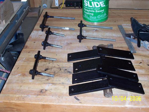

   / L-39 SKID PLATE & PUSH BAR UPGRADE
#2
Photo #2
Home made "U" bolts, made from 1/4" flat bar stock & 1/2" threaded rod.

Photo #3
Skid plate on ground prior to mounting.

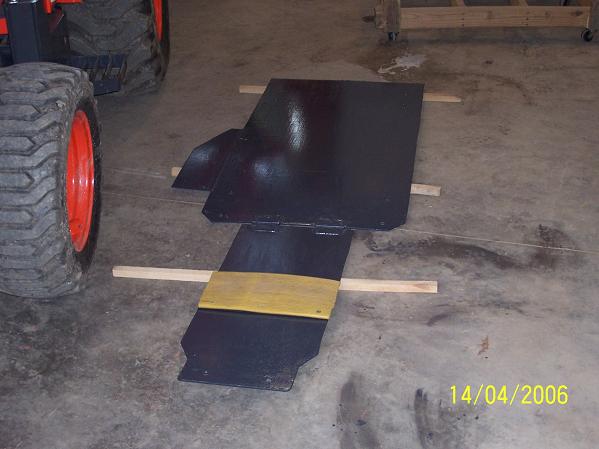

Photo #4
Side view of skid plate.

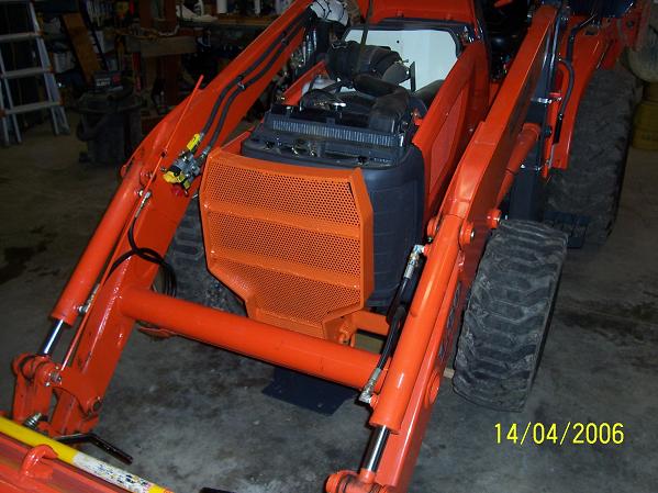

Photo #5
Perforated steel, welded to front push bar.
Note that TSC brand "Kubota Orange" does not match the present Kubota orange. It is more yellow tinted. Oops.... /forums/images/graemlins/blush.gif /forums/images/graemlins/blush.gif /forums/images/graemlins/blush.gif /forums/images/graemlins/blush.gif

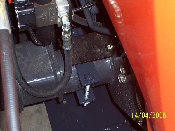

Photo #6
"U" Bolt on the front loader frame.

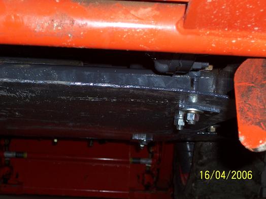

Photo #7
Left side front loader frame

Photo #8
Push bar remounted back on tractor.

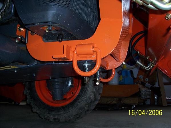

#9
Photo #9
Skid plate mounted on tractor, front attachment to push bar.
