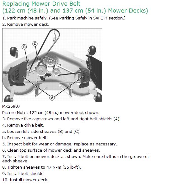

May 7, 2012 / L160 #1 R robertcharles New member Joined May 7, 2012 Messages 1 Location Branson W. MO Tractor John Deere L160 Need a diagram on how to install the belt for a John Deere L160 48 inch deck

May 9, 2012 / L160 #7 B beenthere Super Star Member Joined Aug 16, 2001 Messages 18,564 Location Southern Wisconsin, USA Tractor JD_4x2_Gator, JD_4300, JD_425, JD_455 AWS, added JD_455, JD_110, JD_X485(sold) It does have a 48" deck, so maybe that is the model. Hope he returns. There is a pic in the manual that shows the belt on the 48" D160 deck. Attachments 160_D_deck_belt.JPG 52.1 KB · Views: 282
