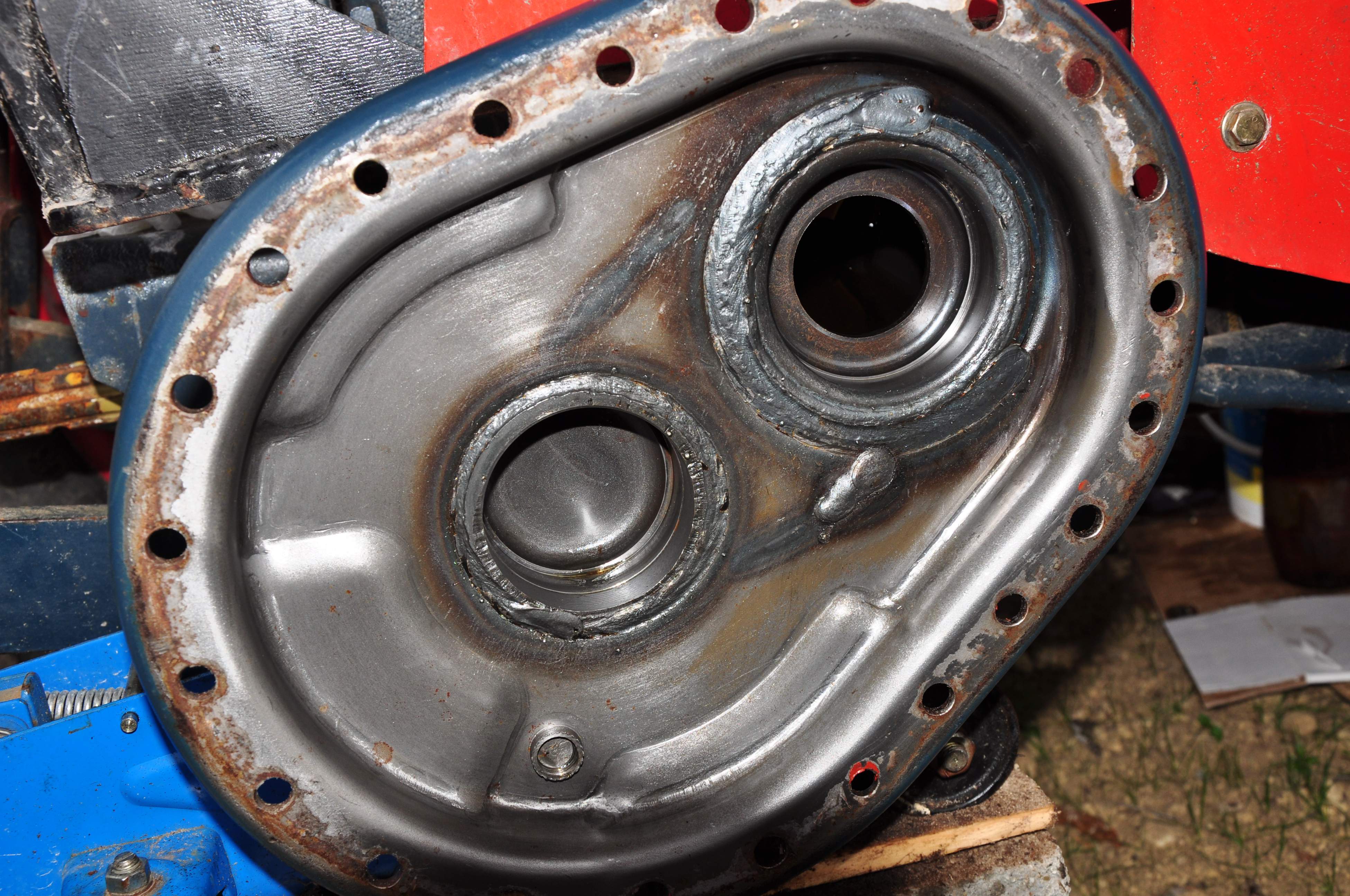

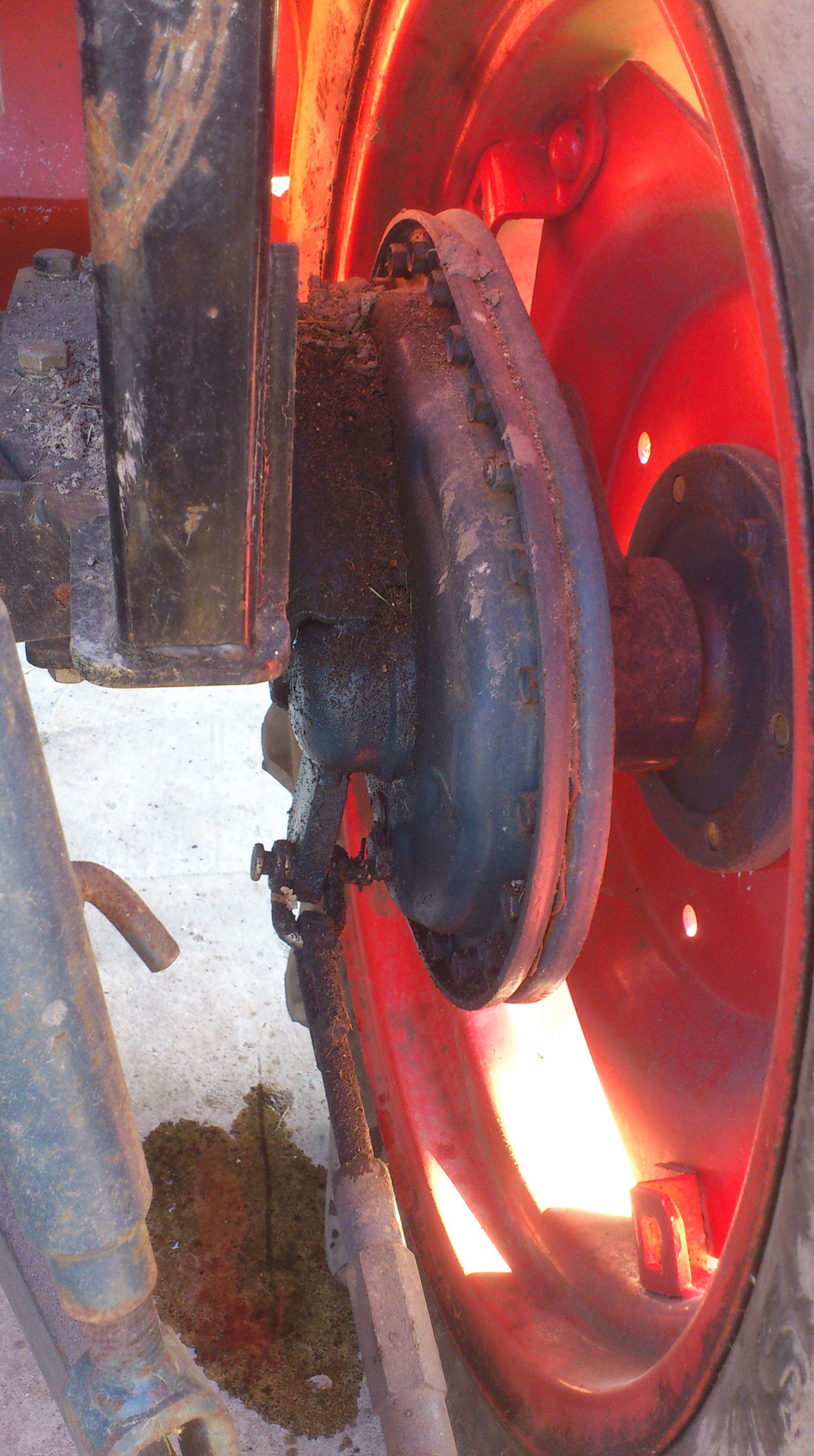

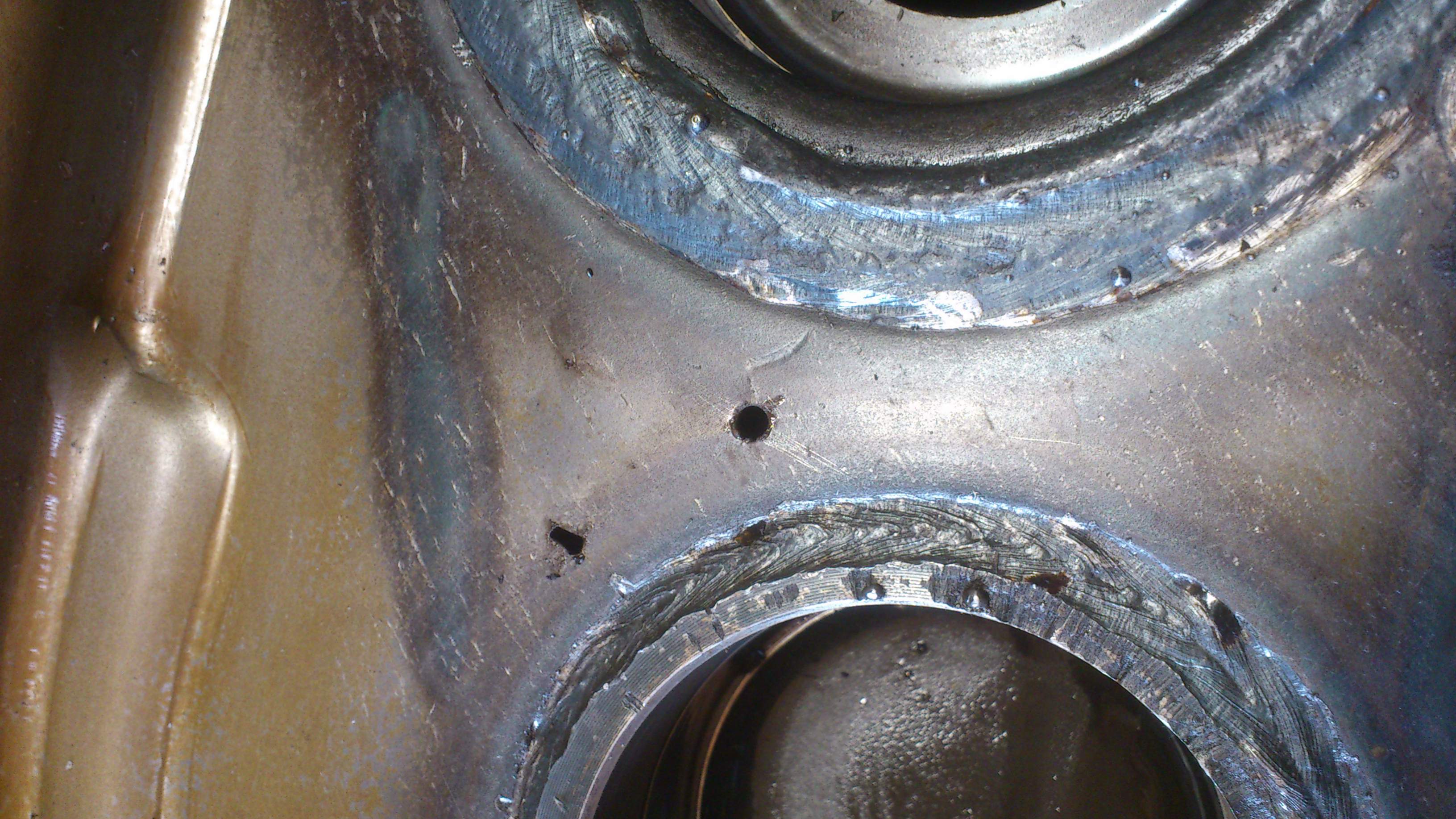

Had this problem for a while, but it seems to be getting worse:

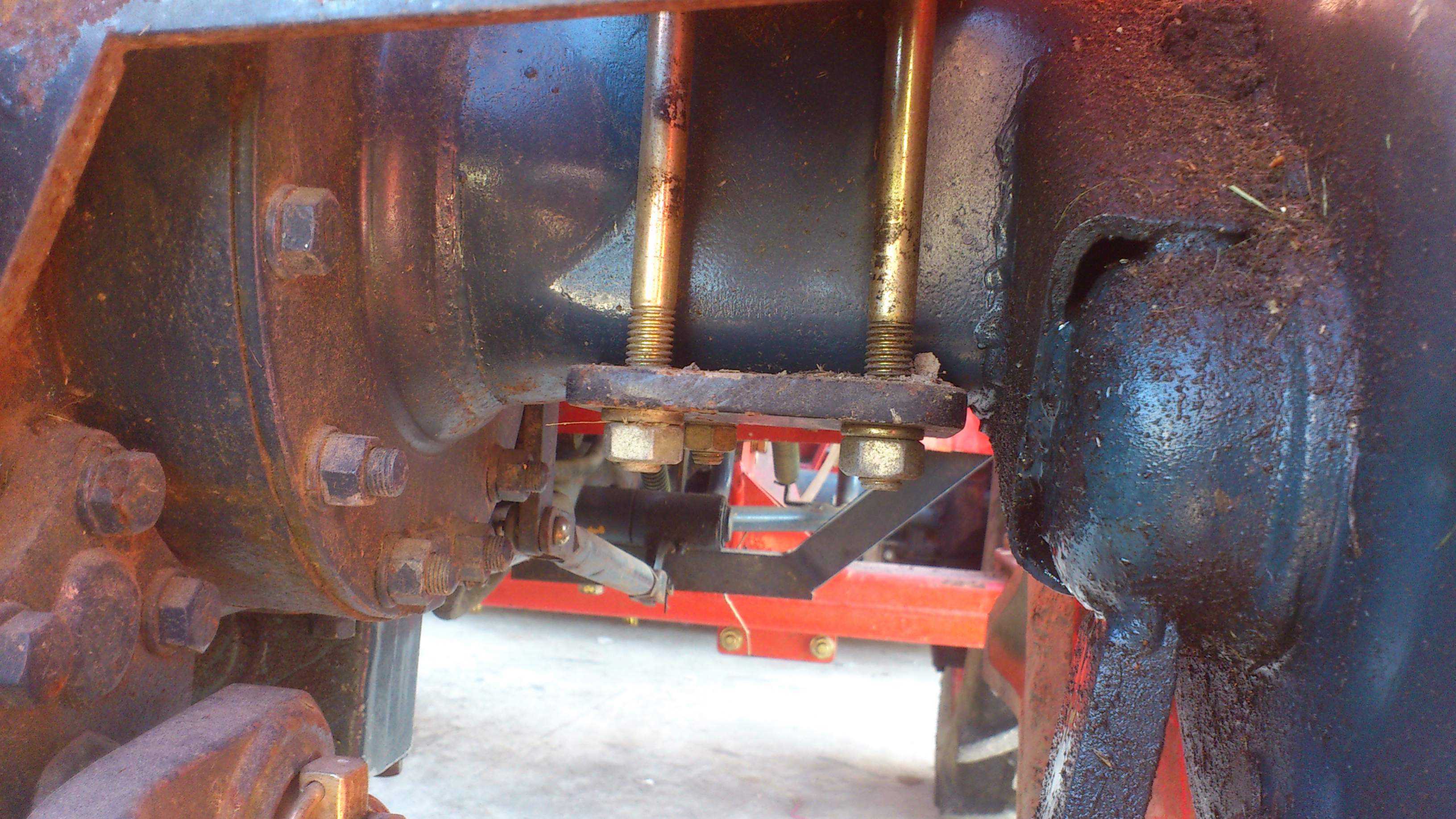

Oil appears to be leaking out from behind the gusset/re-enforcement:
I figured I probably had a hairline crack in a weld, as seen here
so proceeded to dissassembly:

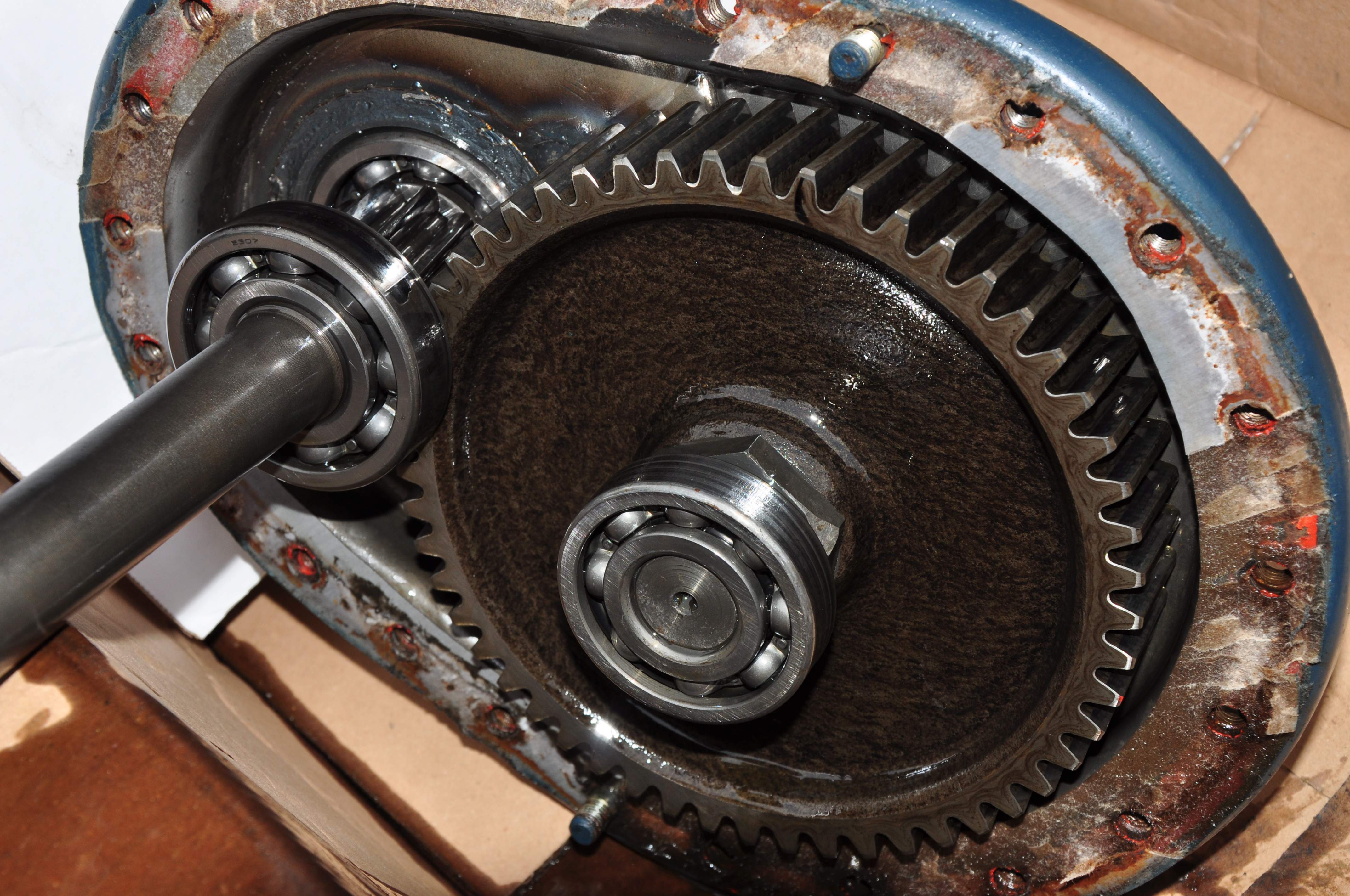

Transmission drained, gear housing opened up:
Mmmm gears :licking:
Uh oh
Not good :(

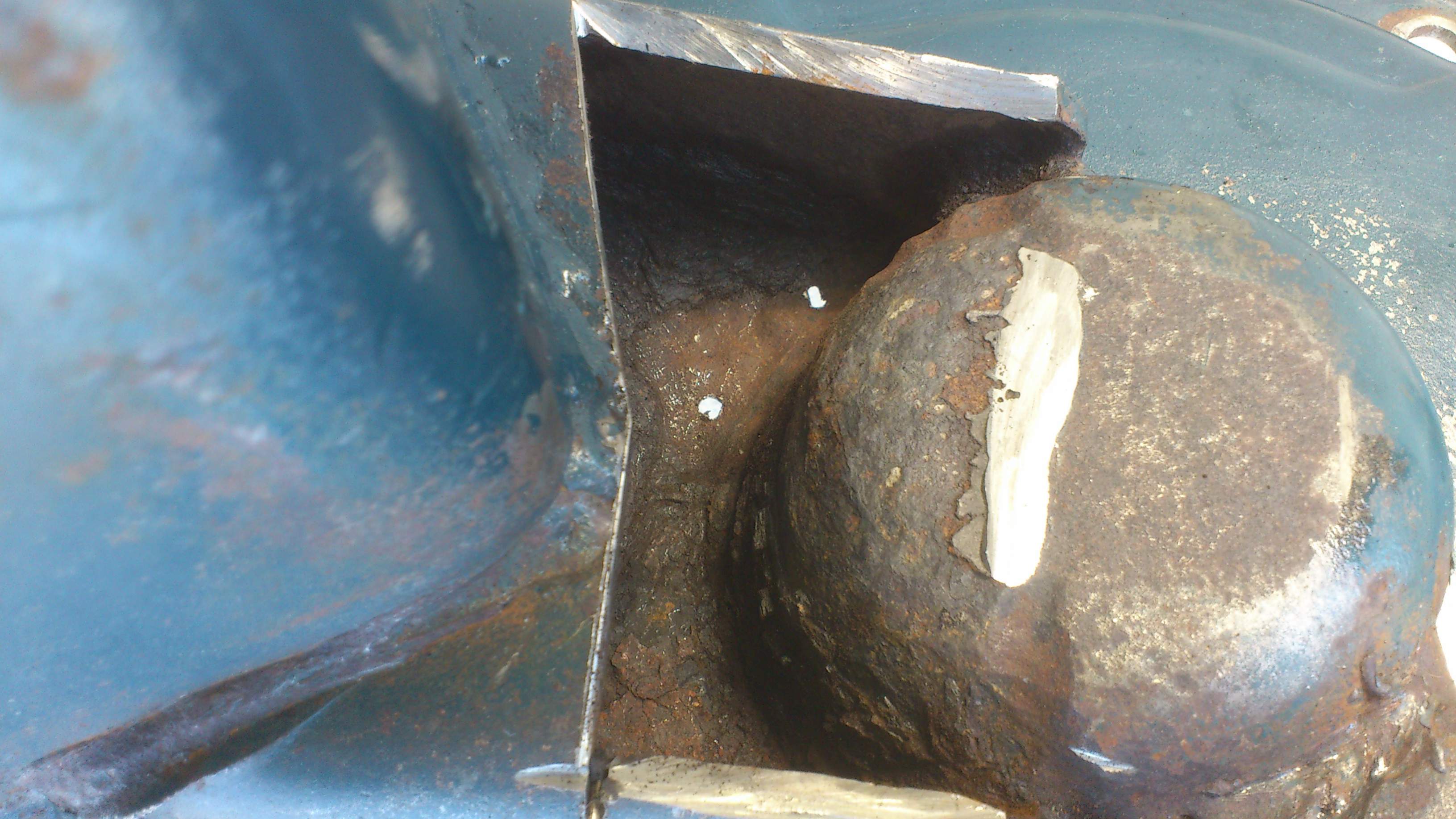

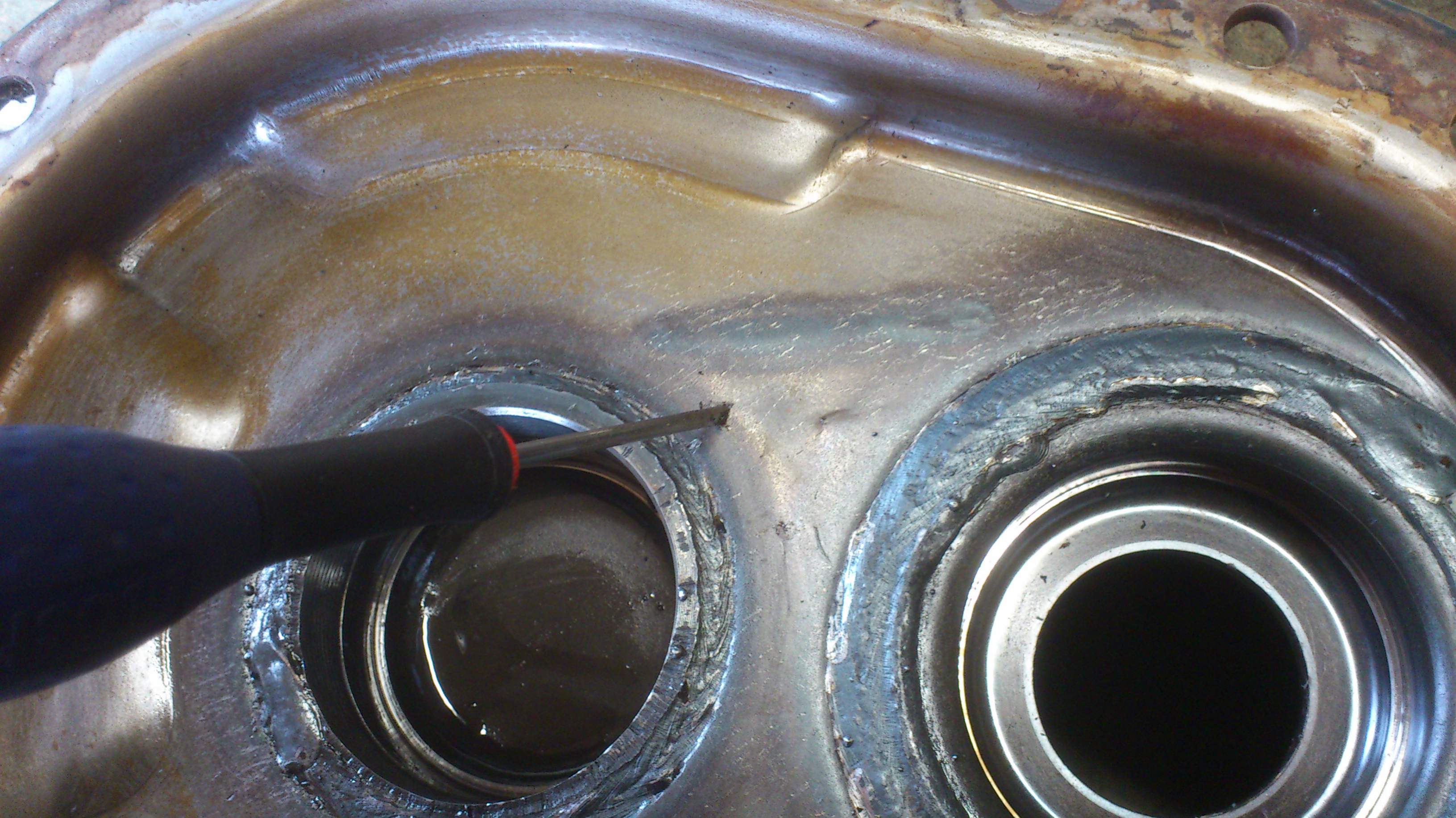

Yep, that's 3/16" steel rusted through from the outside in
Decided to bite the bullet, figure I need to get to the root of the problem somehow:
One huge build up of mud & rust in there, obviously a huge moisture trap. Not entirely sure how I'm going to fix this...

That seems like a really poor design to me. Even I could TIG up the rusted hole, but the design of trapping dirt in there is problem
   / L2042DT rear hub leak - L series weak spot?
Not sure if the gusset thing is factory or not but yes there is a design issue as it only has tiny gaps for dirt to escape from once it's in there (and it will get in there) - definitely something to watch out for on these older L series.
Sadly no Keith Fenner around here (wrong side of the water) but I do intend to "Getter done" one way or the other ;)
What was 3/16"+ of steel has become paper thick:
Repair thread here, suggestions welcome!!

Best fix is to weld it up. Made some suggestions in the repair thread. Several early L series have these welded drive housings including the L2402 as well as L305, L345, L355 etc.
