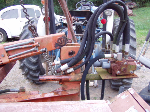

I have a Kubota L245DT. I just installed a Kubota Front End Loader. I used the original Kubota block located to the left of the seat. This block has 2 lines coming out going to the FEL control valves (mine has 2 levers). One line goes from the fill plug near the front of the seat to the FEL control valve. Three hydraulic lines total from the tractor to the FEL control valve.
My 3 point hitch lift worked great before I installed the FEL. The FEL works great but now my 3 point hitch lift will not work at all.
I assume I either have two of the lines switched OR there is a problem in the control valve for the FEL.
Does anyone have any ideas?

This might be your problem. The three lines coming to the FEL should be pressure in to the FEL,and that seems to be connected correctly
A PB line going back to the block for the 3pt, and a return line. These two might be switched.
If the source for the 3pt is getting the FEL cyl OUT fluid, it would only get a little fluid while the cyl is moving.
That leaves the PB from the FEL valve. If it is going to the tank, then no fluid is available for the 3pt.
A hyd gage might help solve the problem.

I hooked up a hydraulic gage like you suggested.
I now know what the problem is.
I do NOT know what the solution is.
My control valve is not factory Kubota.
The control valve is labeled with "IN" and "OUT" ports.
The pressure side from the tractor block is hooked into the "IN" port. The FEL works.
On the "OUT" side of the control valves, the return pressure to the tractor block for the 3 PH AND the bypass return to the gear case, come out of the same block.
The problem is that the block is completely open. There is no pressure on this side on either line, the fluid is dumping straight to the gear case.
I have temporaraly plugged one port.
I plugged the port that was going to the gear case.
Now I have pressure to the lift and the lift will work and the FEL works - EXCEPT if the 3 PH is fully raised and I raise the FEL, the FEL will not come back down until I lower the 3 PH. There is no bypass for the fluid.
What is missing? I do not know what to buy to fix this problem.

If you move the 3pt lever down from fully up, the 3pt valve should be in neutral, and the fluid should go to tank.
You did not say that you had PB out from the FEL. If you only have 6 hoses on the FEL valve you do not have PB.
If you only have two hoses from the FEL valve, then the hyd flow is from the tank port on the FEL. So if you pressurize the 3pt line, the cyl fluid from the FEL has no place to go, until you release the 3pt valve to neutral.
In most cases, the return/tank port goes to tank, but some manufacturers do the cheap route.
If you hold the 3pt lever up, the fluid will be relieved, but the line is still pressurized.

Your 3pt hitch work great before you installed the FEL, because the pump fed the 3pt valve directly and there was only one line from the pump to the 3pt valve. The relief valve in the 3pt valve regulated the pressure. If you raised the 3pt lever to the max, the valve relief, relieved the pressure, until you lowered it slightly to neutral.
