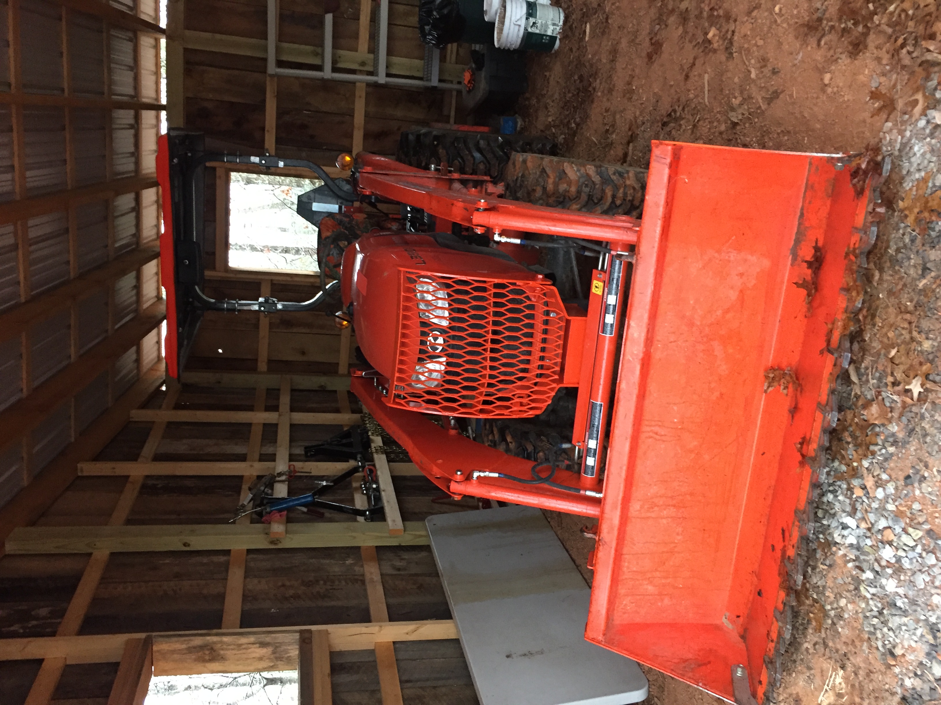

Made mine from 1/8" raised expanded metal.
I tend to go heavy because I do a lot of tree and brush work.

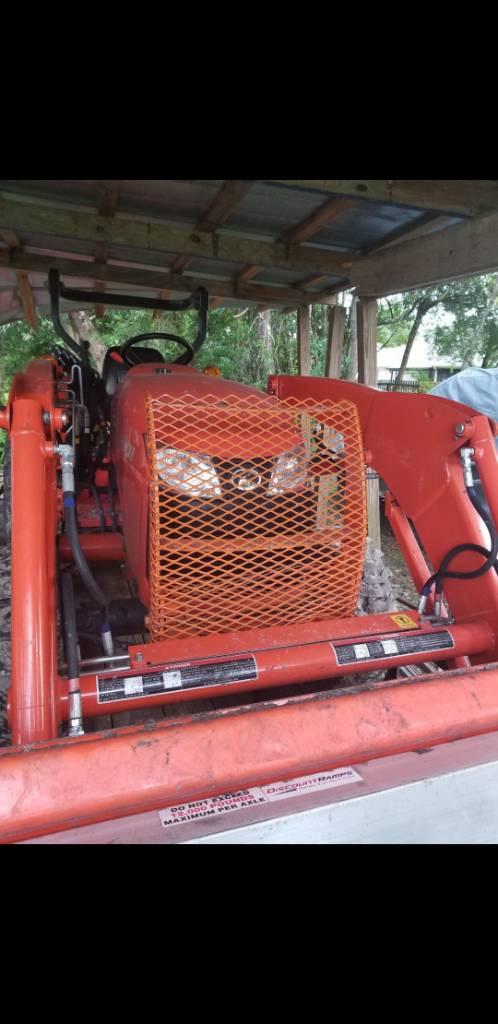

Mine is a lot like wagne223. It's split near the bottom to allow the grill to fold forward.

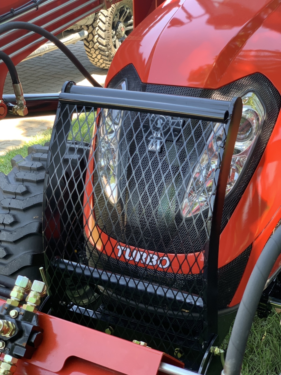

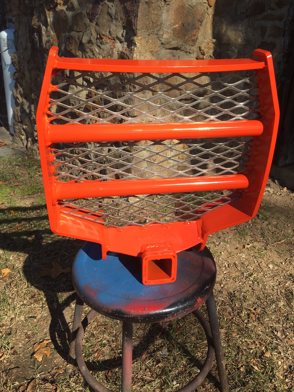

B26 brush guard.
Absolutely necessary for brush work. Found some scrap SS expanded metal at the scrapyard, $2. 3x5” angel at bottom to prevent sticks from coming up. Haven’t used hitch like I use on the bucket. Maybe a tie down point for trailering?
Recently busted the plastic grill on my M59. Had bought heavy rock quarry screen to weld to brush-guard but haven’t got around to fixing. Now have more work to do. Have used perforated metal to repair plastic grills in the past and will be doing again. Kubota had a factory option of a heavy metal hood guard that bolted/hinged to the factory brush guard for the M59. Never seen one except for pictures but like the idea of added protection.

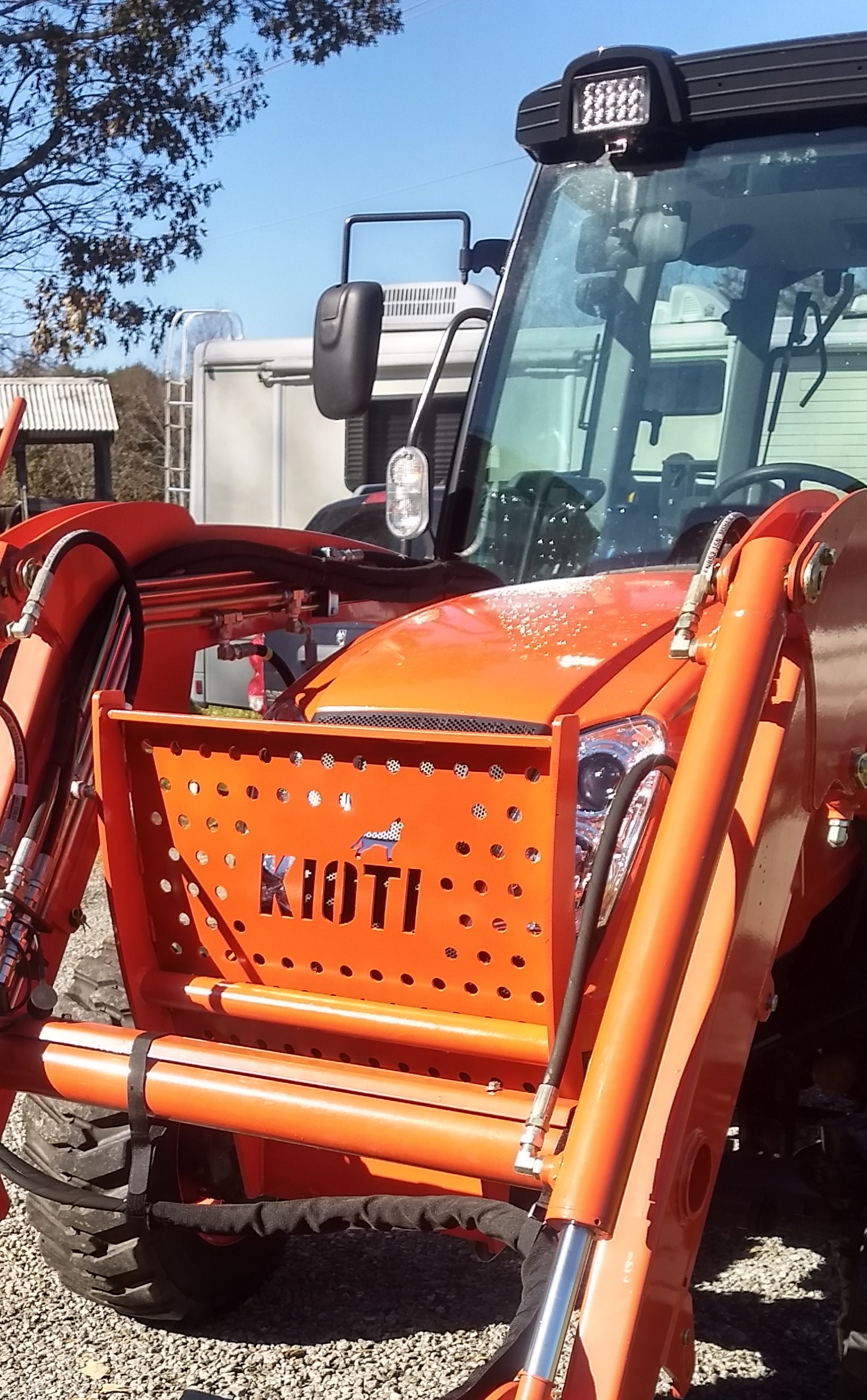

Mine ain't a 'bota but this one is 1/8" plate :) I've smacked it with a couple good ones at least 4" in diameter and held up fine.
