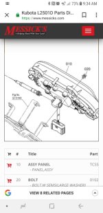

Using the Messiks online parts diagram, it shows the Tachometer as cable driven.
The gauge panel is an assembly.
Therefore I conclude that the hour meter gets its data from the tachometer.
That means the hour meter is more of an RPM counter then a clock.
So the statements that one hour at PTO speed would be 1 hour actual time make sense. Lower RPM will register less then actual time.
My L2501 hours seem to be real close to actual time, however I work my tractor hard and 80 percent of the time I run at maximum RPM which is about 250 rpm more then the PTO mark.
I operate like that because the tractor performs much better and it keeps the hydraulic fluid cooler. Screenshot_20190703-093420_Chrome.jpg
