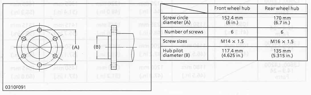

I have GL21, grey Kubota. I'm wanting to switch the tires over to either R-4 or R-3's and I'm probably going to need new wheels.
Can some of you L2800/3400/4400 owners tell me what your lug pattern is, front and rear? Pilot hole also. I would really appreciate it. I'm going to check the axle ratio this weekend and if I can use wheels off a US Kubota I might get lucky and find the correct ratio in tires as well.

These are the measurements your’ after for the L2900, L3300, L3600, and L4200 & I am sure many other models. See attachment pic. KennyV.

Thanks for the post. Those aren't anywhere near what I've got on mine.
I'm hoping the the L2800/3400/4400 are differnet. Maybe the Grand L's match up a bit closer.
Using my tape I measured the following:
Rears
6 lugs on 5-5/16" B.C.
4-1/4" Pilot
Fronts
6 lugs on 4-3/4" B.C.
3-1/2" Pilot

"Maybe the Grand L's match up a bit closer."
/forums/images/graemlins/confused.gif /forums/images/graemlins/confused.gif /forums/images/graemlins/confused.gif
The ones I gave you are Grand L's... KennyV.

Ah, I see. I thought the Grand L numbering scheme was similar to Lxx10, or Lxx30. Those Lxx00 must have been the original models?
Thanks for the information though. Maybe the 2800/3400/4400 "economy" tractors are similar to mine then? I'm new to Tractoring and Kubota's so sorry if I don't catch stuff like this.
