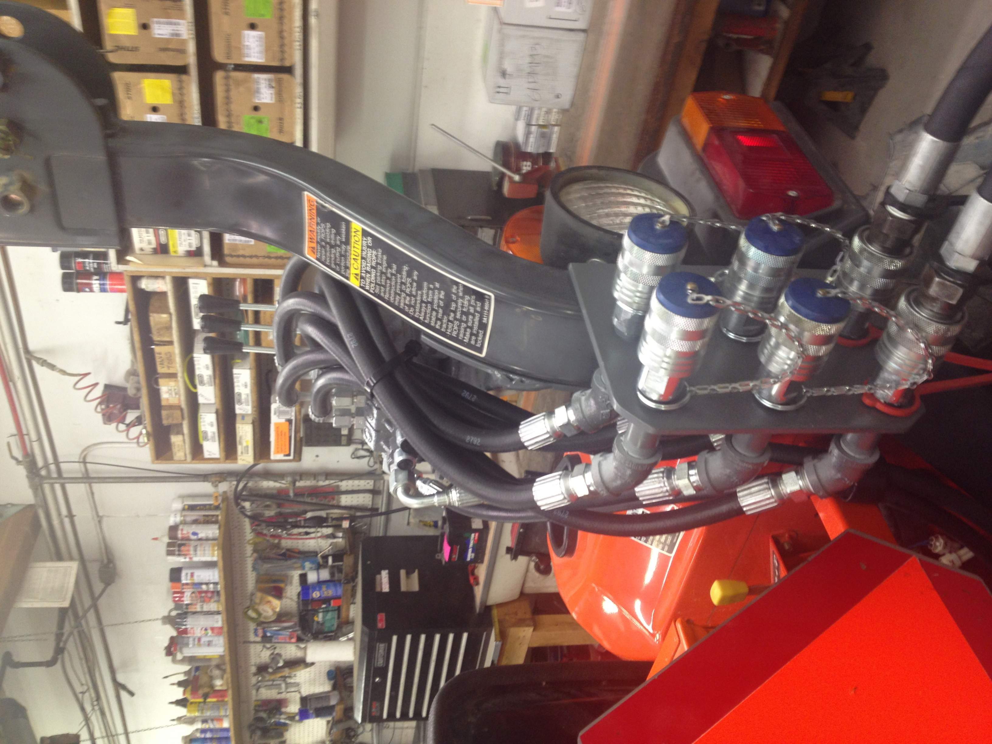

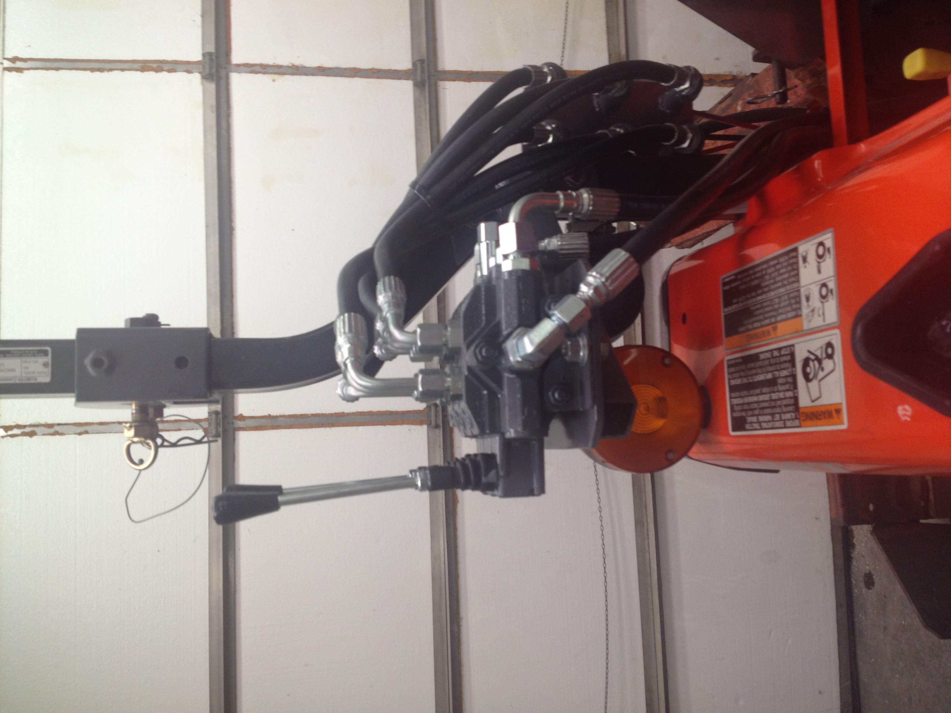

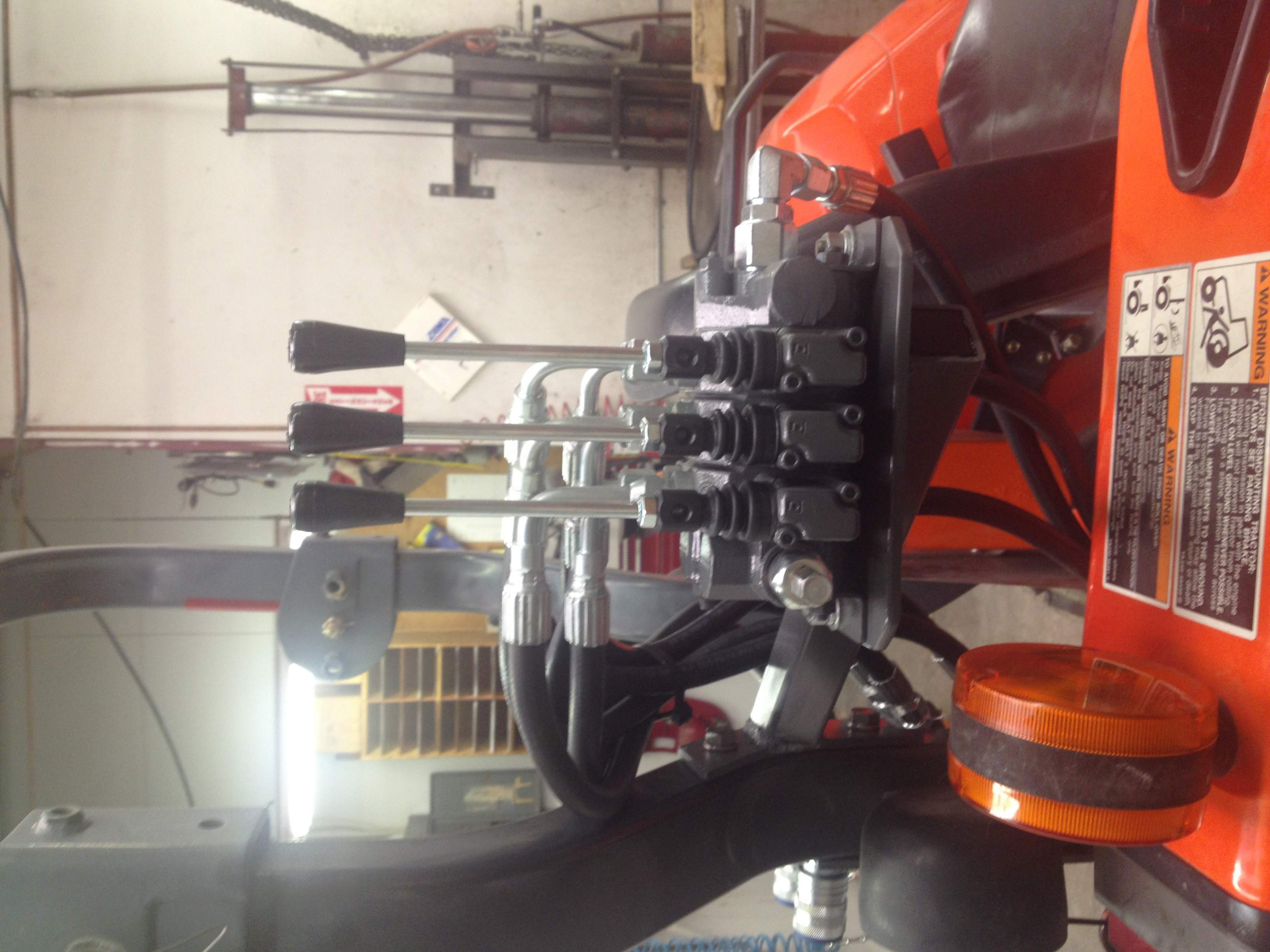

:cool2: image.jpgimage.jpgimage.jpgH]image.jpgHi Murphy,
Just fyi, I got the remotes hooked up-finished today. I used a 3-spool valve I got from fit-rite. Turned out really nice, and it works! Thanks for the help
   / L2800 remotes? #15
Hi Murphy,
Pictures, no pictures, it never happened is the rule of thumb here on TBN. :rolleyes: ;) Actually it's nice for other people to see how it can be done. :cool:
   / L2800 remotes?
#16
I took some pictures, not quite sure how to post them-a little help would be good
