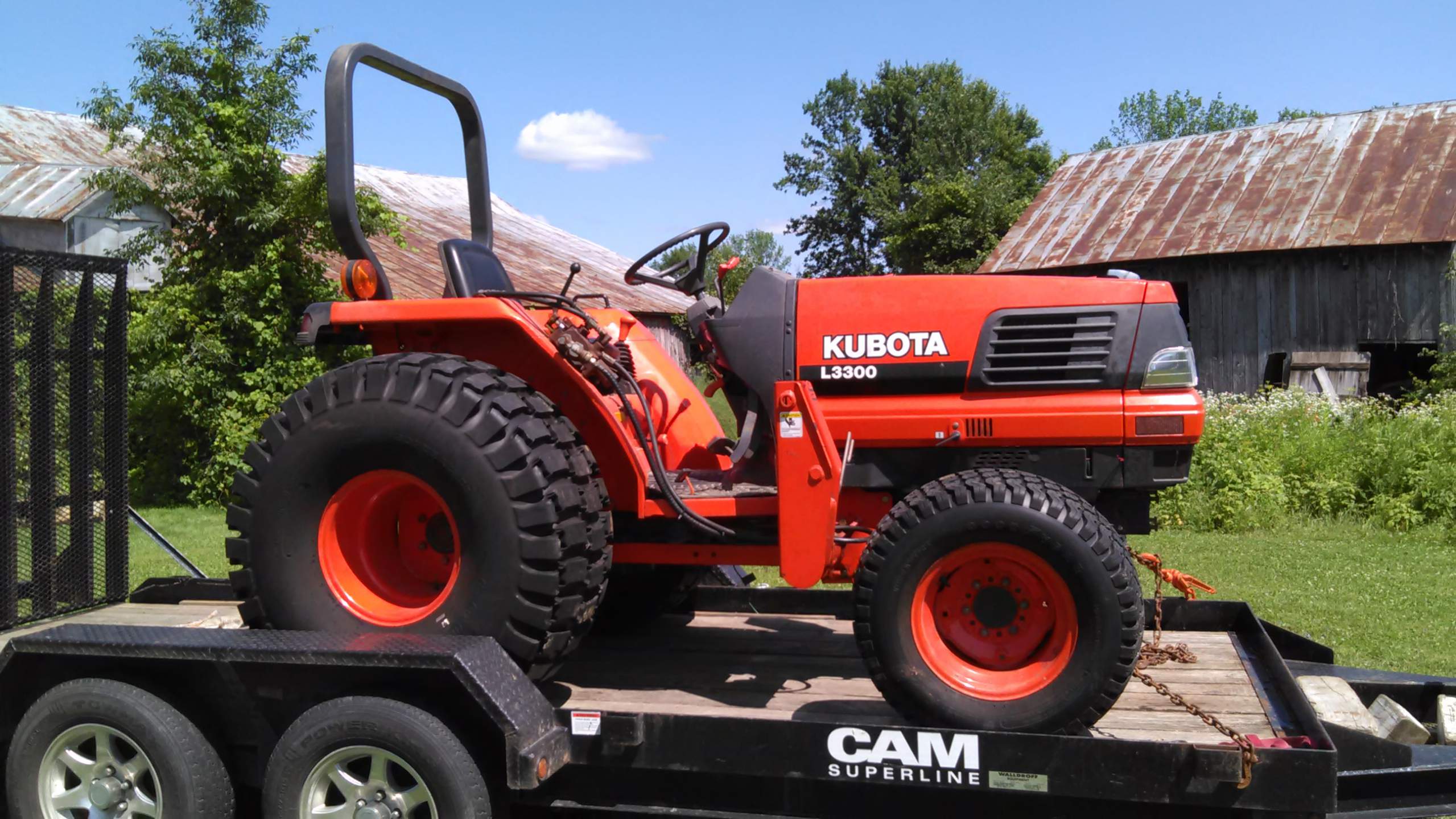

My BIL purchased a L3300 last summer with a brand new never used
FEL and a front mounted snow blower for the unbelievable price of
$12,000.The tractor was stored inside and had "176 hours" on the clock.
Turf tires,only used to snow blow the original owners drive-way.
This is a 1997 model.Good buys are out there but rare.This tractor also is
similar to the L2900.

   / L2900 - Opinions & things to look for? #6
I would snag that ina heartbeat
If the tires are not loaded I would get them loaded for snowplowing tho
