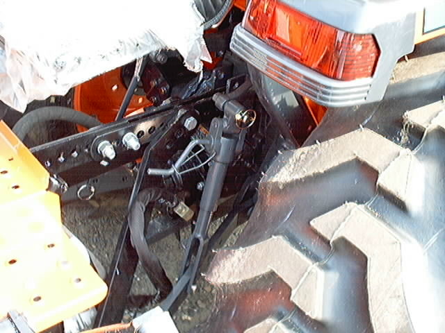

   / L3010 pricing/Woods backhoe #3
3 Point Mounting for Woods Backhoe on L3010
"You are what you eat, drink, think, say and do..."
   / L3010 pricing/Woods backhoe #4
If that's a Woods 7500 backhoe, the price is good. Maybe you could get another $500 off. You dont need the pto pump, but of course the seller probably wants to get rid of it with the hoe. Dealers and owners here in CT consider the Woods 7500 to be as good as the Kubota 4690.
Be aware that the Woods 7500 comes in a subframe mount and a 3ph mount. Most people consider the subframe mount to be stronger and safer. However, they are incompatible with a belly mower, if that is important to you. If you dont use a belly mower, then you might want the Woods subframe mount.

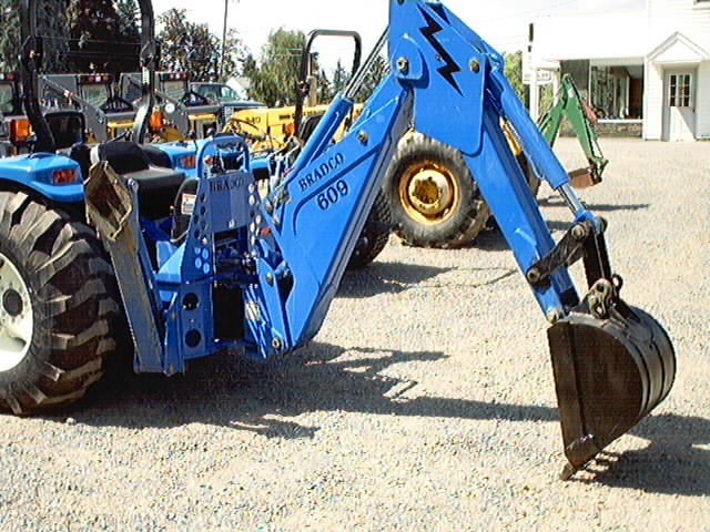

   / L3010 pricing/Woods backhoe #10
Bradco Backhoe on NH
