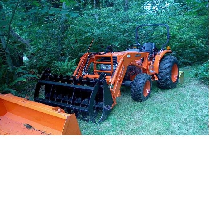

Photo attached of the L3130 ...what a joy to operate. /forums/images/graemlins/grin.gif
Grapple hydraulics are not quite right though. Very weak when closing but if I set it face down and open the grapple it can easily lift the tractor.
I borrowed a pressure guage from the dealer and it appears to be getting 2400 PSI at one spot up front I checked.
Here's what confuses me though. I have an electric diverter valve plumbed off the curl circuit. I wanted to reverse the control direction of the grapple relative to the bucket curl and swapped the hose connections right on the back of the grapple where it T's off to the two cylinders...I thought that was all it would take, but then the grapple wouldn't open at all!
Confused I put it back and all works as it did before...weak close, strong opening. Not sure what to make of the complete stall when I reversed the hoses.
One other thing, when I am closing the grapple, the hydraulics sound like they are _really_ straining. Even when doing so in mid air. I'm thinking that there must be some blockage at one of the cylinders/hoses?
Any suggestions would be appreciated.
