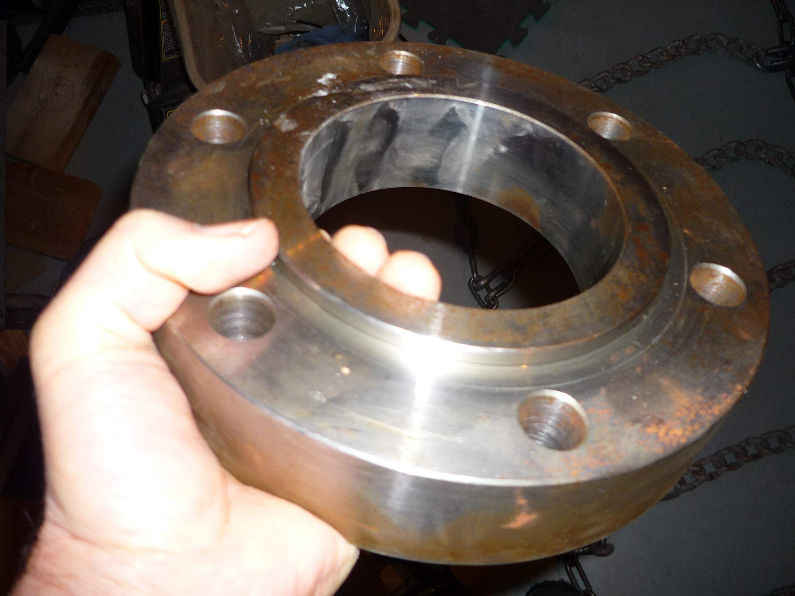

I plan to get spacers for the L3200 so i can mount chains. But the aftermarket ones offer spacing from 1.5 to 4.5".
What is the spacing for the oem spacers? Anyone know what they cost?

I can tell you that the Kubota spacers for the L3400 I got were 1.75", and I think they listed for $220 or so, with the studs, but not the required nuts (which I found I could order thru Home Depot (!) very cheaply. I found them, new, for $160 on Craig's List from an ex-Kubota dealer who was clearing out his odds and ends. I like the fact they add some weight, unlike the aluminum ones.

I bought 2" spacers from Bro-Tek. Absolute piece of art. They come will all studs & bolts. Now I'm wishing I'd gone with 3" or maybe 4", just for the increase in stability. But yes, even with the 2" spacers I'm more comfortable on slopes.

Deerslayer, same answer from me as Gem... they seem to help with pushing a plow in a straight line, look better, and certainly helps on sideways stability, although that wasn't my reason for getting them. In my case, the tires don't really seem to stick out so much that it looks odd. I have turfs, by the way, and they only mount one way, compared to R1s or R4s, where they can be mounting closer or farther out.

Guys, the $220 list (I am guessing that what he said it was) was for the pair, with 12 studs- it may have originally included the needed nuts, too, but the bag was open, and the price was right. I installed them myself, but then, my rears are not loaded, so rolling and muscling them are not a big deal. Getting the 4 old studs out was a pain, using double nuts and a bit 'o heat on one or two. Nothing damaged, but that was the hardest part. That, and finding the M16 1.25 (or whatever they were?) nuts. Like I said, you can order them for cheap via Home Depot, grade 8.8 even, but I was in a hurry. Got a couple nuts just to have as spares.

Bro Tek now $350 delivered to U.S.
   / L3200 spacers? #12
In case anyone is interested, here's a photo of the steel OEM spacers (Kubota L3400 - 1.75") before installation. The part number was L8886, FWIW.
The new, longer studs screwed into the drive axle, and the spacers just slip over them, then the wheel.
