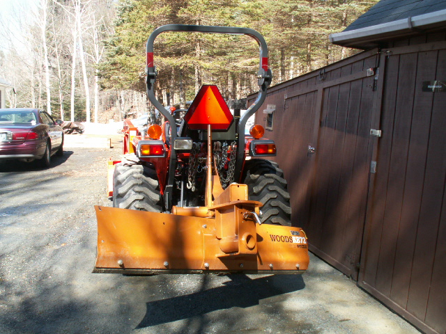

Hi Guys. I have had an el cheapo rear blade from TSC for a few years now and have bent it up a bit using it to do dirt work on my long drive. I would like to get a heavy duty angle/tilt/offset blade that is 72" wide. I looked at the Land Pride RB3572 in the catalog but wonder if this is too much blade for my L3400? What would my limitations be for this blade with my tractor? Does anyone have this combination?

I've not used this blade but I don't think it is too much. I see specs are 6 foot width, 484 lbs, 35-80HP rating. The weight is not a problem lifting, and beneficial for blade performance. Looks like a real nice rear blade.
There are a couple topics in the Attachments forum for this particular blade and it seems well regarded.

Have you check out Woods72...all the same thrills.
