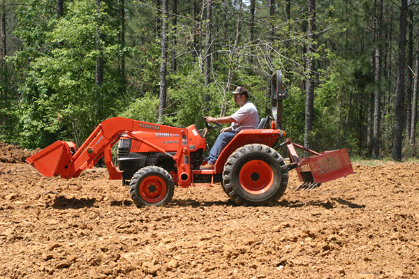

I beat you all, only 2 hours on mine so far! I have not used the PTO yet but I have been using the box blade for 1.5 of the 2 hours and the FEL for the other 30 minutes. Yes! YES the 3pt lift is REALLY jerky and it is really making box blade work difficult. Actually at times the FEL seems a bit jerky at times but that may just be me, nothing big.
So far all in all I am VERY pleased. That dirt you see felt like a concrete block after years of neglect and a week of logging operations that used it as a staging area. The box blade broke that up quickly once I figured out to shorten up the top link to get a better bite and less blade action. Yea I had to do several passes to get good depth and will probably do several more passes at right angles next weekend but it did the job. I can not see spending $38K for a larger machine (JD 110) that would do it faster. Sure it's nice but that's a LOT of money.
