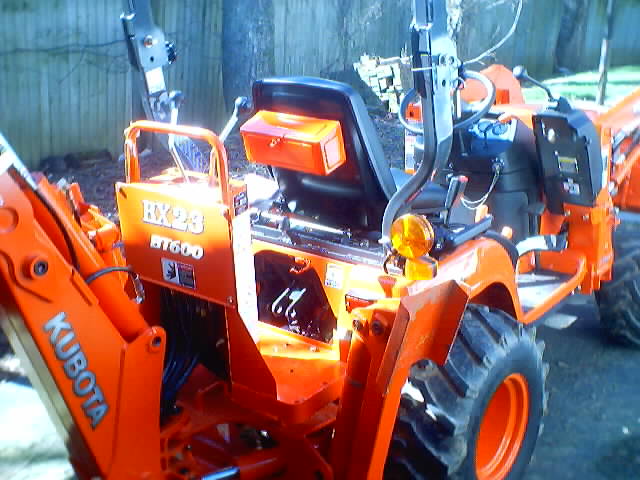

The BX23's seat has a grouping of six threaded inserts on the back that are covered w/little plastic plugs. I'm told they are for adding the optional armrests. I used two of them to mount an 11"x4"x4" metal tool box and it's done pretty well for me.
I don't know if the L3400 series has these optional armrest mounting tabs but if it does then one might mount a toolbox to it like I did.
Theres a thread about it and some other ideas somewhere around this forum.
Good luck as a tool box of some sort is a definite need on a tractor /forums/images/graemlins/grin.gif
