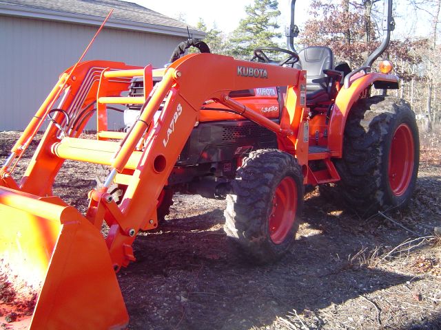

They are both great machines but faced with some of the same questions as yourself, I purchased the 3430. I had ZERO experience with any tractors but this forum clarified some things that would be useful to me on a tractor. I wanted to brush hog mostly and misc. projects on 10 mostly wooded acres. The advice about getting the most power available in the particular size you're shopping for is simply good advice. I looked at the 3400hst and the 3430hst. I know the price of the 3430 was thousands more but well worth it. The 723 loader with quick-tach bucket is enough reason for me to pay more. The independant PTO is nice when going from one brush hogging project to another. In the end, as far as tractors go, your money doesn't depreciate as soon as you drive it off the lot. I was looking for a used 35hp kubota for well over a year and was shocked to see that 300-500hr units were only $1500-$2500 cheaper than new. So you might as well buy the best you can afford cause if you need to sell for any reason you won't loose much. Be sure to post pics of whatever you end up with:) GOOD LUCK, Jay
