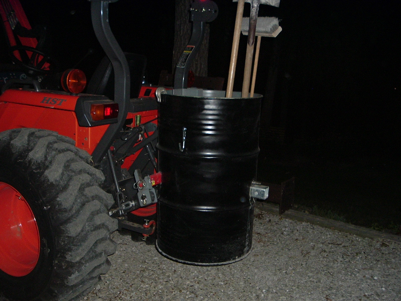

   / L3400 wheel spacers (and/or telescoping bottom arms)? #4
These are pretty cheap, Carter and Sons. quick hitch. Works pretty good, they dont snap in like the Pats, and they sure arent an I-match, but they do work, and saved me a lot of hide, sore body parts, and helped my vocabulary a bunch.
James K0UA
