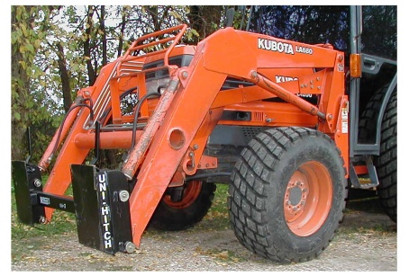

I have a Kasco (Unihitch) that I put on my LA680. They make the adaptors for many loaders. I got it through my Kubota dealer. I think it was around $500.00… It is very handy and allows me to hitch any skid steer type attachment to my L4200 Kubota. I also have a boom pole, forks and various buckets, change is a snap /forums/images/graemlins/cool.gif. KennyV.
   / L3400dt - quick attach for fel? #3
I had intended to attach a picture…KennyV.

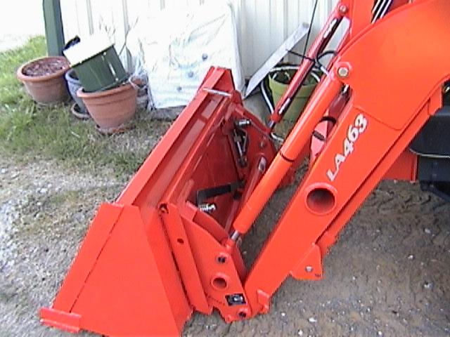

I have the L2800 and the dealer welded a QA plate on the back of the bucket and used a QA that is specked for the LA513 loader, it has the spring loaded arms.
   / L3400dt - quick attach for fel? #5
</font><font color="blue" class="small">( I have the L2800 and the dealer welded a QA plate on the back of the bucket and used a QA that is specked for the LA513 loader, it has the spring loaded arms. )</font>
Could you please post some pictures of the QA.
Steve
   / L3400dt - quick attach for fel? #6
Here is one pic. I will get more.

Thanks for the pics,it looks real good. /forums/images/graemlins/cool.gif
