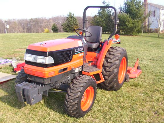

Sammy,
I have a L3410 HST. I would never never never buy a tractor that wasn't HST. The operation of the tractor is SO easy for ALL operations.
