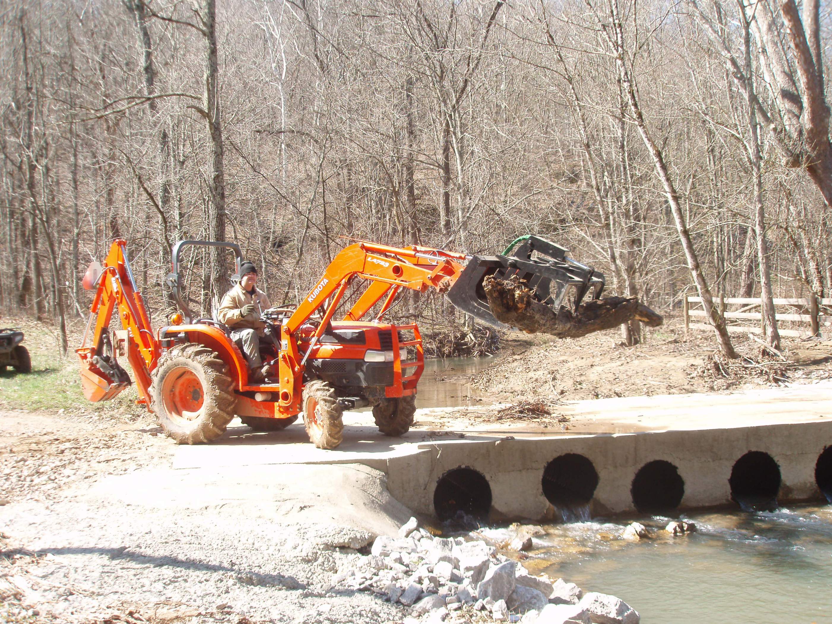

The L3430 is a great medium sized compact tractor that can handle what ever comes it way. Sure, there are times I want a little more horsepower, but considering the nimbleness of its size, even with a backhoe, I have learned that there are tradeoffs in life. I looked at the MX5100 this past year, but after careful consideration, and with the help of others here, I decided that there is always something bigger, and while the bigger tractor will do a few more things than a 35 hp tractor, it will also use more fuel and take a bigger truck to trailer it.
The hitch on mine works smoothly and while the L4330 and up had a larger loader series, the LA723 still lifts an impressive amount (1500+ lbs bucket bottom), and there are times that I can lift more with the FEL than the muddy ground under the front wheels wants to hold up without leaving ruts.
One other item, the L30 Series Operators Manual list the 60" tiller as the max, but I am glad to hear the the L3130 ran at 72" tiller in tough ground.
