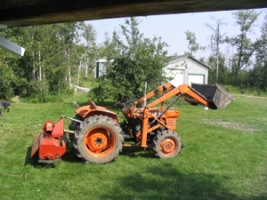

Here is a pic of my L245DT I can get better pics if needed.

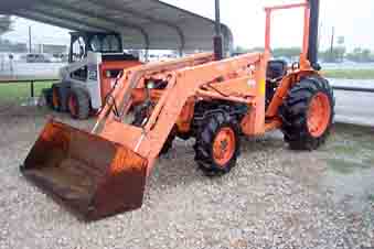

Here's a link to a photo of a page from Kubota's L1720 brochure. Also found a picture (attached) of a loader on an L355.
I think Kubota put different loaders on in each country - I've noticed some Canadian L345's with loaders that look quite different from the L1720. The L345 is long enough so that many loaders designed for other machines should be adaptable to it. Don't skimp on the subframe and you'll be fine.
There is a small 4-bolt cap under the left side of the seat which is where you tap into the hydraulic system. If you take off the cap, you'll see how it works. The original cap covers two holes and just reroutes the oil flow from one hole to the other. Kubota sold an "adapter" which was an aluminum block with two through holes tapped for hoses. It also had the four bolt holes, and grooves on the back for o-rings to seal the block. Pretty easy to make.
Any open-center loader valve will work. If you have a choice between loaders, go for one with smaller cylinders (maybe 2" bore). That keeps the forces reasonable and will move fast enough with the internal hydraulics - 345's don't have a very big pump. Big cylinders will mean the loader will be s-l-o-w and will lift more than the tractor can handle.
