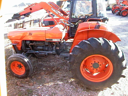

I went back and took some pictures. It is a 2wd and appears to have a long frame. I notice on TractorTips that the L345FW was only sold in 1985 and weighs about 400 lbs more than the L345F. It is about 5'6" wide and 10' long.

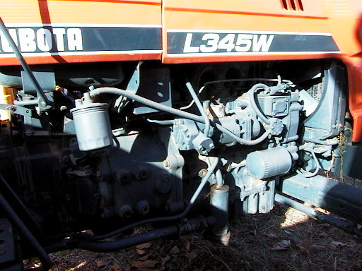

Here's a picture of the decal and engine.
Good point about the FEL. If it is a longer frame than the L345, I guess I need to ask a Kubota dealer about putting a FEL on it.

Bill, it looks like the machine is in pretty decent shape with no signs of abuse however I think the downfall here would be trying to put a FEL on this unit and operate on sloping terrain. It might work alright in a flat barnyard for moving materials around and light grading but I'm sure the limited traction of the 2wd would make negotiating a hill with any weight in the bucket frustrating and even dangerous. Just ask anyone with a 4wd unit how useless their machine is if switched into 2wd. I would recommend looking a around little more, a 4wd machine half the size of this one would outpull it on a slope, especially in reverse.
   / L345W in Texas #9
Bill - comparing the pictures to the L345 brochure I have, the tractor is normal length for the model - these are long tractors, they have a wheelbase of 76-1/8" c-c and an overall length of about 11 ft to the end of the front bumber/weightbar. Interestingly, the picture shows a loader frame front bracket on the tractor - U-shaped affair with flat plates on each side of the hood above the front axle. So in its past life it had a loader? The original rops on this model was sometimes part of a loader and/or backhoe frame. The missing rops may be another clue about its history?
My guess is the W stands for wide. The front wheels look deeper, with more offset than the standard ones. Maybe for enhanced stability with a loader.
Dick Bargeron ---- Cheerful refund if info is bogus /w3tcompact/icons/smile.gif
   / L345W in Texas #10
Bill - a couple more observations from the pictures. It appears the tractor has been repainted - not a deal-breaker by itself, but maybe a hint of a hard former life. A lot of engine parts are blue that weren't originally - radiator shroud, oil filter, fuel filter, alternator, starter, paint over decals, fuel lines, linkages, missing shield beside radiator fan, missing cage around alternator. Also there's a hydraulic oil leak on the right side filter canister where the tube is welded to the top - probably got hit and is cracked there - not a major issue unless hydraulic oil has run low. Nothing big - but maybe an indicator of what kind of maintenance it has gotten. The oil and fuel filters have not been changed since sometime before the paint job. /w3tcompact/icons/hmm.gif
