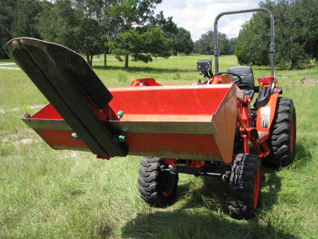

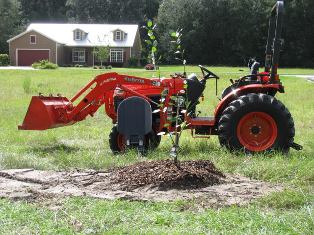

I wish I had a backhoe about once every few months, so it's not a necessity but sure would be nice.

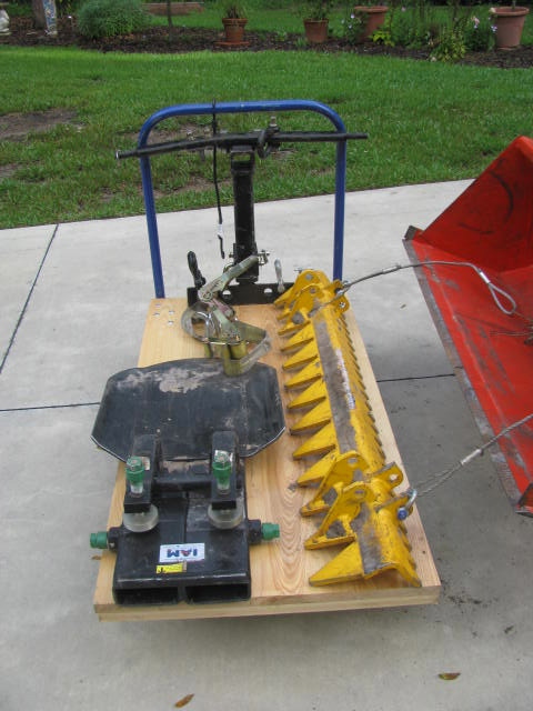

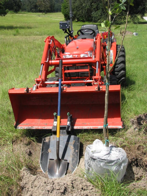

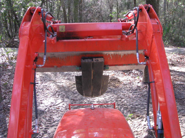

I have found a Bucket Spade to be very useful and a fair substitute for a backhoe except for trenching. My 33-hp/1,900 pound tractor has about the minimum bucket "beef" to make a Bucket Spade effective.
Tractor Forks, Bucket Forks, Loader Forks

Jeff, I would be really careful with that bucket spade. That looks like a great way to destroy a bucket by bending it in the middle.
   / L35 questions #8
Thank you for the caution.
Spade is well engineered. There is 14" of support under the bucket. It is a snug first BEFORE the screw pads are tightened. I have used it a lot. The only bucket wear is some minor paint scuffs where the screw pads contact. Good tool.
That said, I would not mount it on the bucket of a BX series sub-compact tractor.
Snohomish.....nice there, along the river. I have family in Everett.
