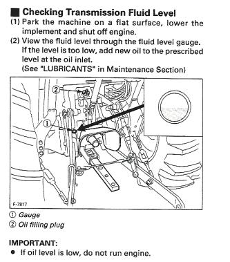

My neighbor has a L3600 not HST and that's about all I can tell you about it. He thinks the hydraulic fluid is low, but the dipstick isn't where mine is on my B2410.
We didn't look under the hood. but can someone point me to it's location? Or do you just fill it until you see the fluid in the filler hole?

My L3600 has a site window in the rear of the tractor. I have attached a copy of the location from the manual. Let me know if he needs anything else.

Thanks for the reply. I didn't think about a site window. I will take this to him this week end.

have him check the owners manual, that should tell him how to check it. it may not have a dipstick.
   / L3600 Dipstick
Thats the problem, he doesn't have a manual. Bought it used and no manuals with it.
Looks like from what TonyC attached it doesn't have a dipstick.
