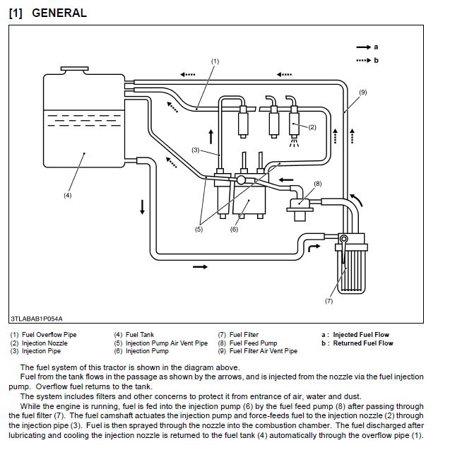

I was working with my L3800 and it just slowed down and shut off. If I try to start it, it stars but will only stay running for a few seconds. I pulled the fuel filter out and cleaned it, put it back on but it still will not start. The fuel gauge read 1/4 full, but I put another 5 gallons in just to make sure that maybe the gauge was not working. The fuel bowl is only half full of fuel right now which makes me think that it is not getting any fuel. I did check the bleeder valve and it is close. Any suggestions??

If the fuel bowl is not filling, bleeding is not going to help, You have a stoppage upstream.. Crap in the tank or hoses. Blow compressed air backwards toward the tank, and see if you can get the bowl to fill, but I suspect you are going to be pulling off hoses and trying to clean out the tank..

This overall diagram might help some.. as you can see the fuel pump is after the fuel bowl.. If the fuel bowl won't fill. I still say you have a stoppage in the tank or the line from the tank to the fuel filter and bowl.

That's for that diagram. I am going to try to blow the lines. I will also try starting it with the cap loosened. I let you know what happens. Thank you all. This forum is like instant service. :)
   / L3800 Died..Help
Blowing the line from the fuel bowl to the tank fixed it. When I pulled the line, nothing came out. I put my air to it and after a few seconds, fuel starting pouring out. I hooked the line back up, when to start the tractor, it was rough starting do to the air in the lines, then it was normal. I cranked up the throttle and it sounded strong. It's been idling for about 5 minutes now with no issue's. Thank you k0ua and everyone else.
