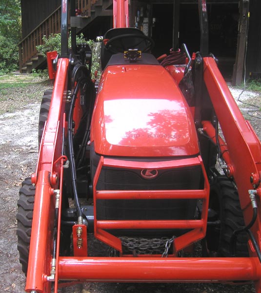

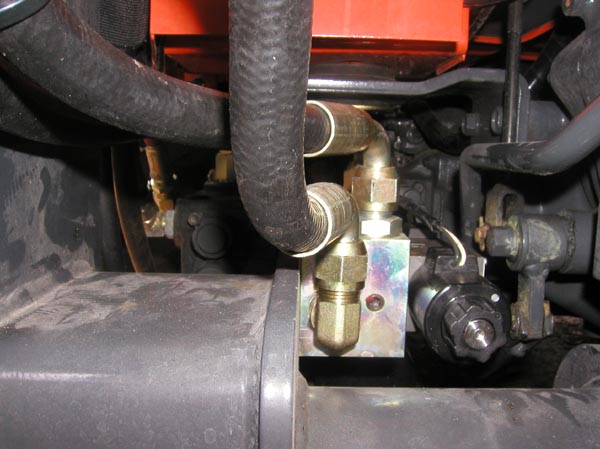

We installed the Kubota OEM front FEL remote hydraulics as well as the Kubota 3 rear remote hydraulics.
These hydraulic tubing lines are huge @ 1/2" diameter compared to the ones on the BH & FEL. /forums/images/graemlins/grin.gif

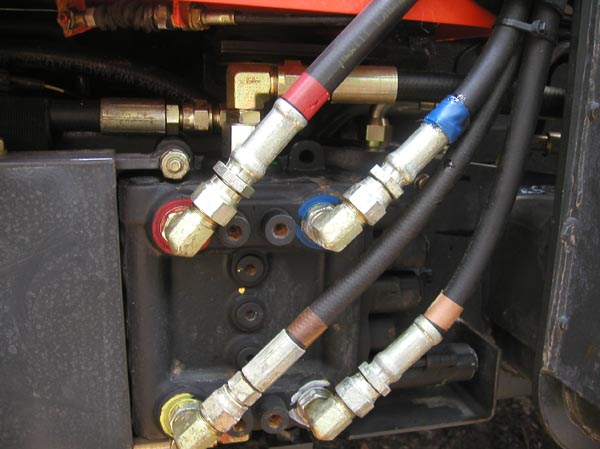

   / L39 Front & Rear Hydraulic Power
#2
Here is the Grappler tubing and solenoid that is wired into the FEL joystick for operating the front end remote.

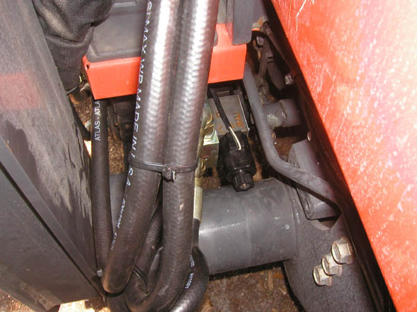

Here is the same Grappler Tubing and electronic solenoid shot from above looking down onto the pump.

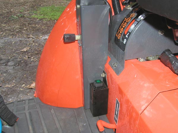

This little remote electronic solenoid installed at the base of the FEL joystick column turn the front hydraulic on and off.

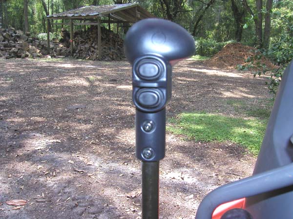

Last but not least is the new FEL joystick with the electronic buttons for operating the FEL Grappler. /forums/images/graemlins/grin.gif

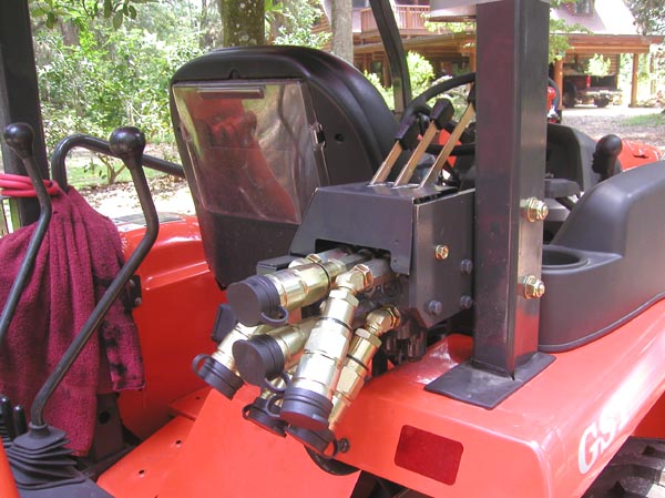

The three rear remotes are under pressure all the time, regardless of the BH or 3PT hitch link setting.

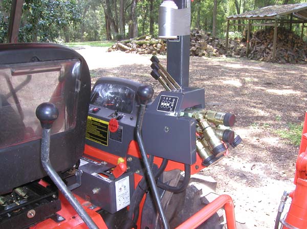

The three rear remotes made a sano installation adjacent to the instrument panel.
