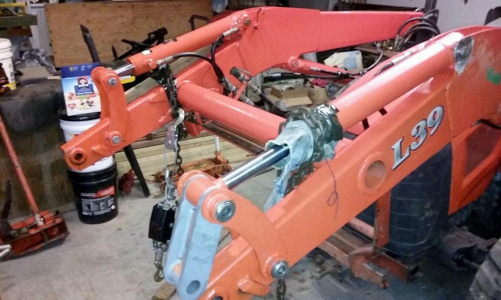

Loader cylinders also have been replaced with 5mm larger than OEM at 60mm for the lift and 65mm for the curl (just 5mm smaller than an M62)
At +8,000lbs, increased lifting capacity, and slight power bump the machine is as strong as it needs to be for its weight. Runs great with about 2600 hrs.

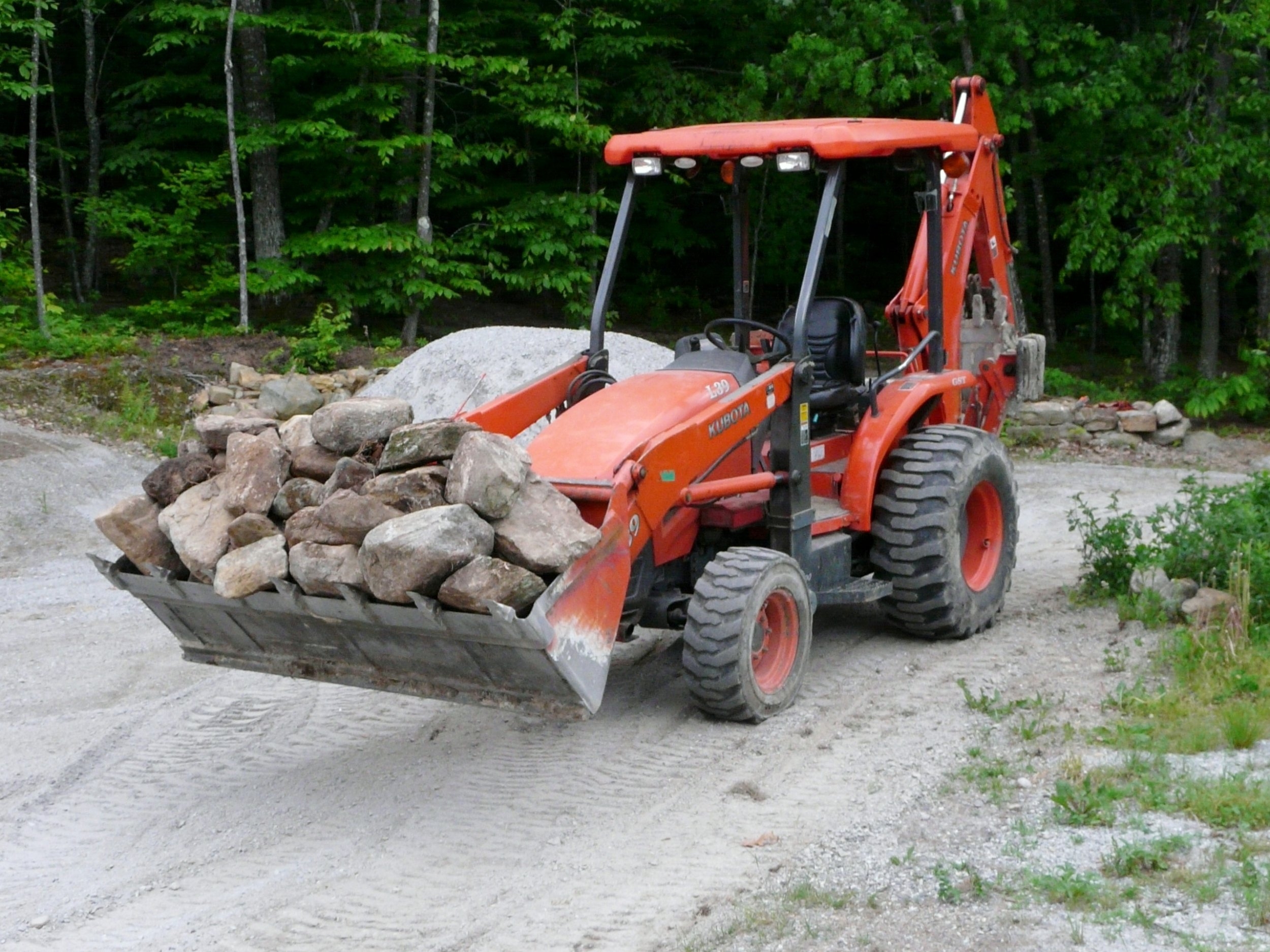

Increased lifting capacity by pumping more fuel? Maybe I'm missing something, did you put a 100 gallon tank on the BH bucket to add more counter ballast to keep the rear wheels on the ground?

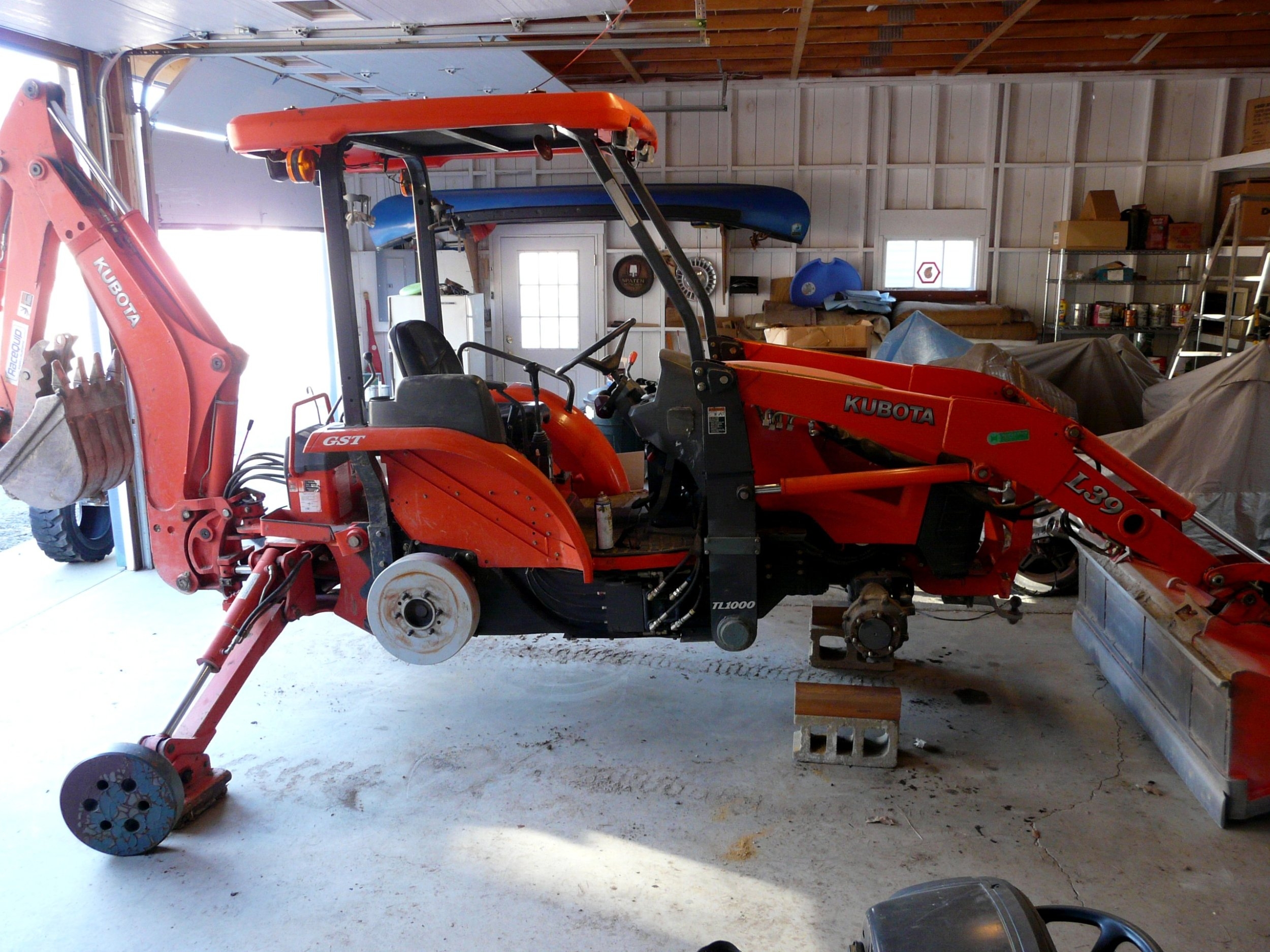

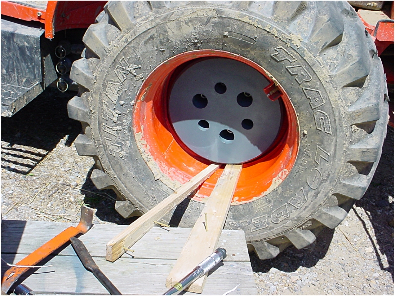

750 Lbs of wheel weights and upped Cylinder sizes by 5mm
