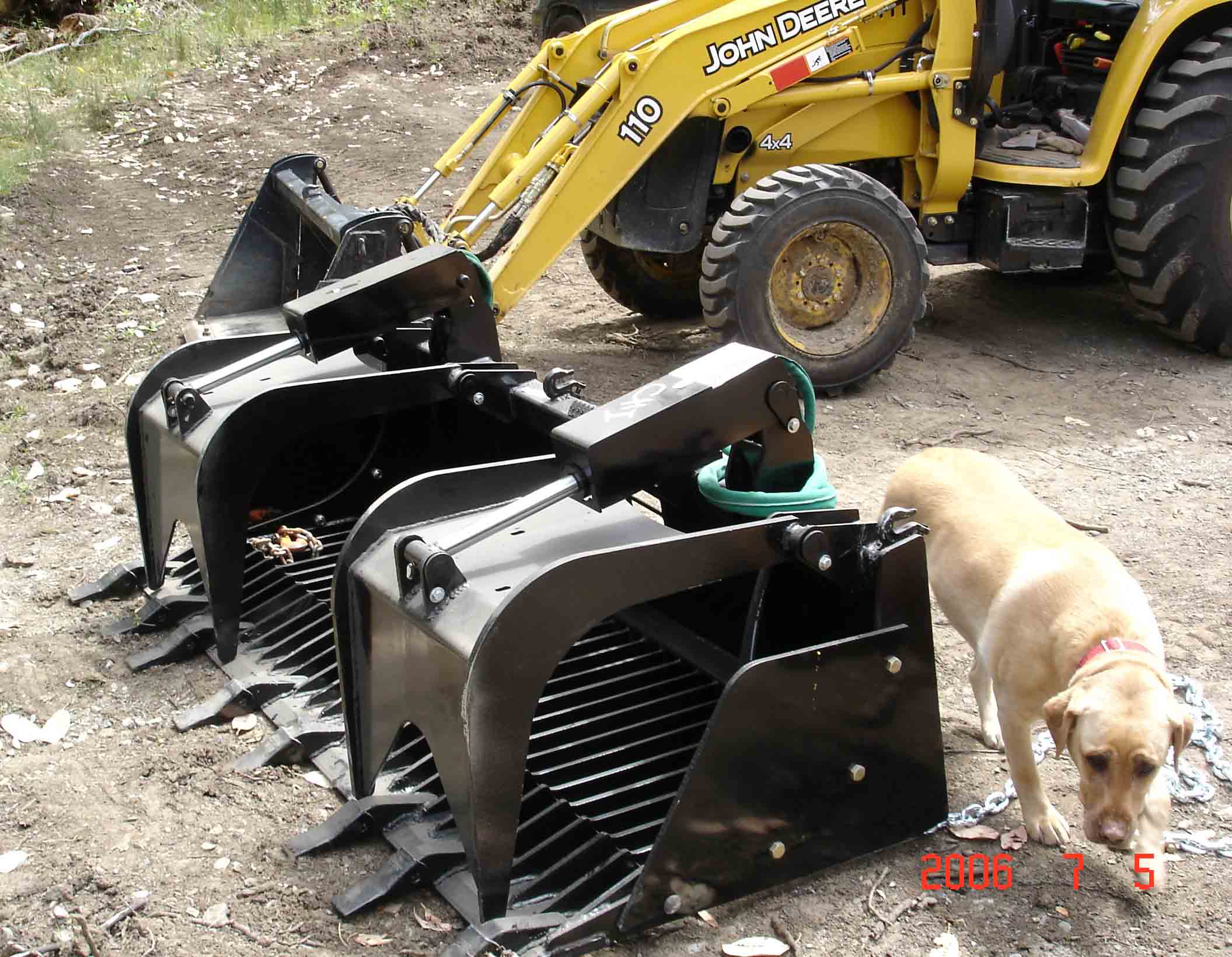

I just bought one of their rock buckets (with grapple and teeth) for my JD TLB 110, and while the item delivered did not look exactly like the picture of the rock bucket, it was even better. What I got had the "finger" spacing of the rock bucket, but the design of the root grapple, with side plates added. I paid an extra $20 for the three grab hooks to be welded on.
Shipping weight was 1003 pounds for a 72" bucket. Take a look at the attachment. (No, the chain is not attached to my dog, the chain is what I used to offload the bucket from the delivery truck.)
This thing is very heavy duty, and I am quite satisfied with it.
You would probably need a special attachment method, or an adaptor, since my 110 takes standard skid steer attachments.

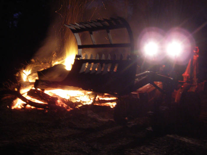

I've got the 66" ANBO Root Grapple on our L-39 @ 850 lbs with 300 hard hours of use, I doubt if you need a full 72" unit.
